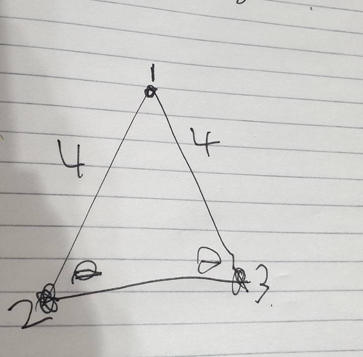

Three long, straight, parallel wires all lie in the yz plane and each carries a current of 20
A in the positive z direction. The two outer wires are each 4.0 cm from the center wire.
What is the magnitude of the magnetic force on a 50-cm length of either of the outer
wires?
answer is 1.5 mN
f12 (l) = (uo * i1* i2)/(2pi * r)
243775
This is how I visualize the problem (of course I am drawing this as if it is in the z-y axis); I don't know what will be the next step. Anyone please help me.
Thank you
I don't see how the wires could be in a triangular arrangement if they all lie in the same plane. I'd imagine it'd something more like this:
243779
Edit: By the way, your Relevant Equation, as stated, gives the force per unit length of the parallel wires.

hey, thank you for replying to my question
If I put them that way they won't give 1.5 mT and I don't think we can use the cosine law in that case

No need to use the cosine law. Check out my edit to my post above.

Aren't those wires parallel, and the length is 50 cm?
The wires are "long" and parallel. You're only concerned with a 50 cm segment of each of the outer wires.
does it give that answer if you do so? if Yes, can you tell the difference between this question and that question, please: Three long, straight, parallel wires each carry a current of 10 A in the positive x-direction. If the distance between each wire and the other two is 10 cm, what is the magnitude of the magnetic force on a 20-cm length of either of the wires?
Because that way doesn't give the answer in both and I, honestly, can't find a difference?
(note: for the second question, I had to draw an equilateral triangle and use the cosine law)

Yes.
There they specify that the distances between all the wires is the same: 10 cm. That forces a triangular arrangement and they will not all lie in the same plane.
gneill said:
Yes.
Yes, I understand now what is happening
Thank you so much for clarifying; after the first couple of questions, all involved a triangular arrangement I thought these questions can't be solved without the cosine law!
