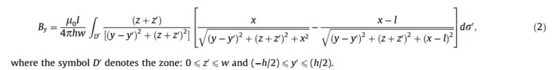

I am essentially using Biot-Savart to compute the magnetic field in a discrete armature section (P) from a discrete rail section (P'). I am doing this following equation 2 from this paper in MATLAB.
Equation (2) for B_y from a thick rectangular conductor: B_y = (mu_0 I)/(4 pi h w) times the integral over D' of (z + z') divided by [(y - y')^2 + (z + z')^2] times [x/sqrt((y - y')^2 + (z + z')^2 + x^2) - (x - l)/sqrt((y - y')^2 + (z + z')^2 + (x - l)^2)] d sigma'. Zone D': 0 <= z' <= w and -h/2 <= y' <= h/2.
To my understanding, this equation shows the magnetic field at an arbitrary point (P: x,y,z) outside the rail. So, to find the magnetic field at each point in the armature, I currently use 5 loops. Two to loop through the rail positions (y' and z' with the long rail dimension being essentially infinite) and three to loop through the armature positions (x, y, z). I am following a test case Here is a block diagram of my current code.

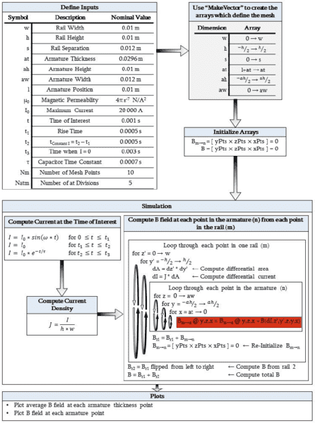

Additional Question: Even though I'm not currently doing this, I will be adding a temporal loop as well. This will mean the length of rail producing magnetic field will change, and I will need to add a 6th loop to account for discrete rail sections in the x (long) direction. How do I define volumetric current density? The current is not contained in the long (flowing) direction that way. It seems incorrect to just divide current by the length of each section because the current flows that direction. However, I cannot just not divide because then my solution is simply a factor of my mesh size, since the magnetic field contribution from each section gets added together.
Flowchart of a railgun magnetic field simulation: input table of rail and armature dimensions, mesh setup, current and B-field loop calculations, and plot outputs.

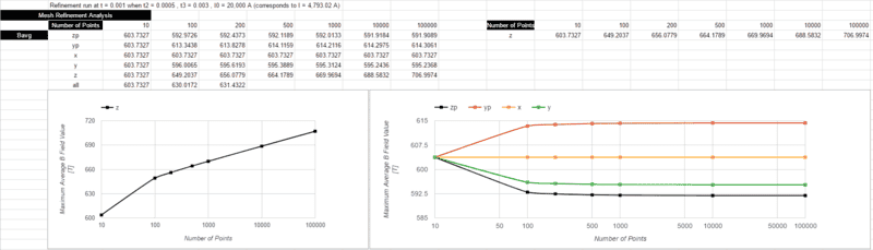

I am computing the integrals as simple sums (midpoint rule, I guess), but I see relatively little change by adjusting mesh size. If this sort of simple integration were a problem, I should see significant and unstable changes with mesh size, correct? Below is the mesh refinement analysis I did, where the average magnetic field is plotted for varying mesh size. As you can see, the one unstable variable is the mesh size of the armature width. As the size gets smaller, more elements get closer to the rail (r goes to 0) and this influences the average more than the other points in the center bring it down. But this doesn't show a problem with this formulation, correct?
Spreadsheet of a mesh refinement analysis of average magnetic field values versus number of points, with two line graphs of field value against number of points on log scale.

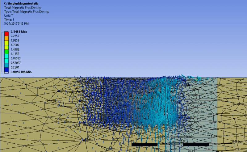

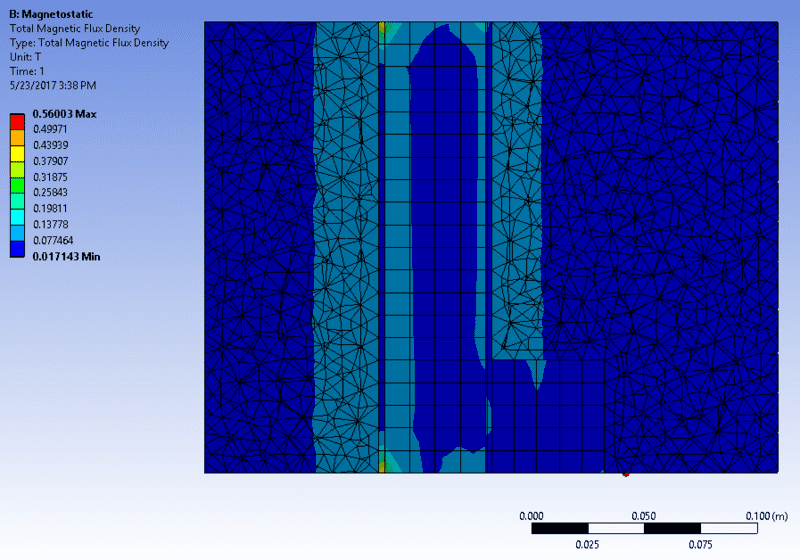

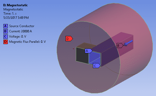

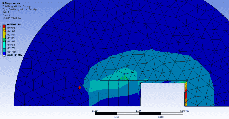

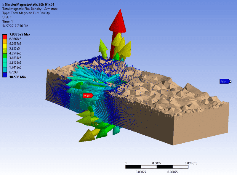

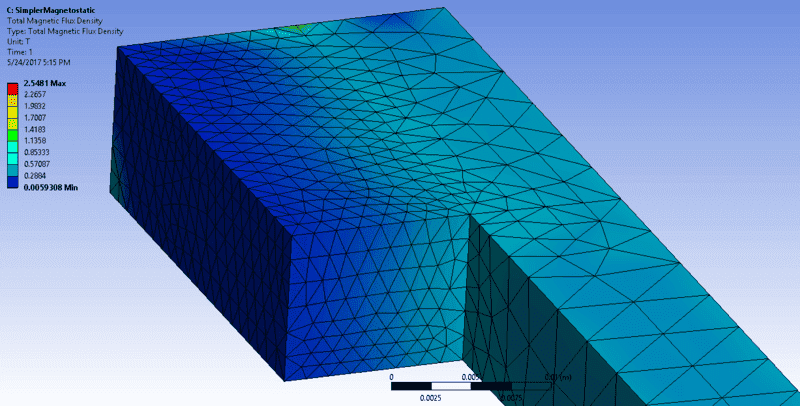

Additionally, I have run an ANSYS Workbench Magnetostatic simulation to check my values further. This gives me yet another result...
I made the mistake of using the wrong scale and going a little to detailed with this model, as you'll notice the rail is hollow (this is a way of getting around using a transient solution because in a railgun the current pulse is so fast, it operates like AC current and only travels in the skin of the rail...I'll deal with that in the rest of my analysis later). The reigon of square mesh next to the rail (copper) is the armature (aluminum), and the surrounding area is just air. I have run another version, but the simulation license is now being used by someone else, so I don't have that result to post. If I recall correctly, that result gave even smaller values. As you can see, the magnetic field in the armature is 0.017 to 0.19 T. Sure, this seems to be at least on the same order of magnitude, but, as shown by the second result image, most of the armature is near the low end of this. Yes, the other simulation has smaller values, but not something near what the MATLAB code is getting now (though I'd have trouble trusting that anyway since I believe the simple approximations the most). Would the result be significantly smaller because the Biot-Savart solutions don't consider the magnetic field needing to penetrate another metal?
ANSYS Maxwell magnetostatic setup of a rectangular source conductor carrying 20000 A inside a cylindrical air region, with labels for source conductor, current, voltage and magnetic flux parallel boundary.
ANSYS magnetostatic plot of total magnetic flux density in tesla around a rectangular conductor cross-section, with a colour scale from 0.01714 T to 0.56003 T and a 0 to 0.090 m length scale.
ANSYS contour plot titled B: Magnetostatic, Total Magnetic Flux Density in T, with a colour legend from 0.017143 Min to 0.56003 Max and a 0 to 0.100 m scale bar; the central conductor region shows the highest values.
106 always sounds like a unit conversion issue.
Did you check how it scales with the relevant parameters? If you double the current, does the magnetic field double? If you reduce the width or height of the rail by a factor 2 (but keep current the same), does the magnetic field at the same position stay roughly the same?
How did you model the current flow at the armature/rail connection in ANSYS? I would expect that region to be quite challenging.

Yes, it does sound like a conversion issue, but the difference is between two models computed from the same constants. I can check to make sure there's no difference, but there shouldn't be. No, but I will check that tomorrow when I have more time with the license. I just have my memory to go off of at the moment, but I don't remember a significant change after changing the rail to a solid beam, and decreasing the rail from 5x5 cm to 1x1 cm.
Agreed. I'm not sure how I would do that with the workbench. I can do it with ANSYS Maxwell, but my laptop with that license is out of commission right now. Anyway, it's not an issue because the MATLAB and other codes don't consider the current flowing through the armature when computing the magnetic field ( the field generated by that current doesn't produce a significant force, so it's neglected ). So the ANSYS model just has the current flowing straight through the rail. The armature is just sitting there, like the surrounding air is.

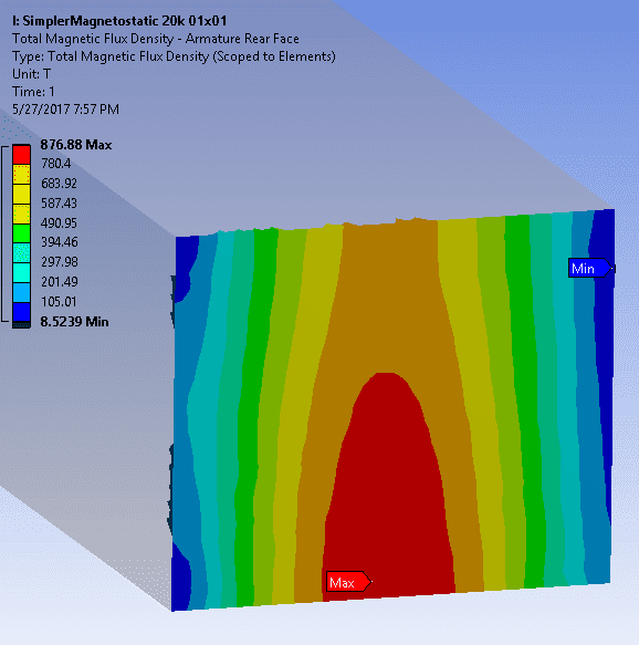

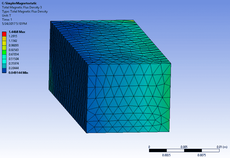

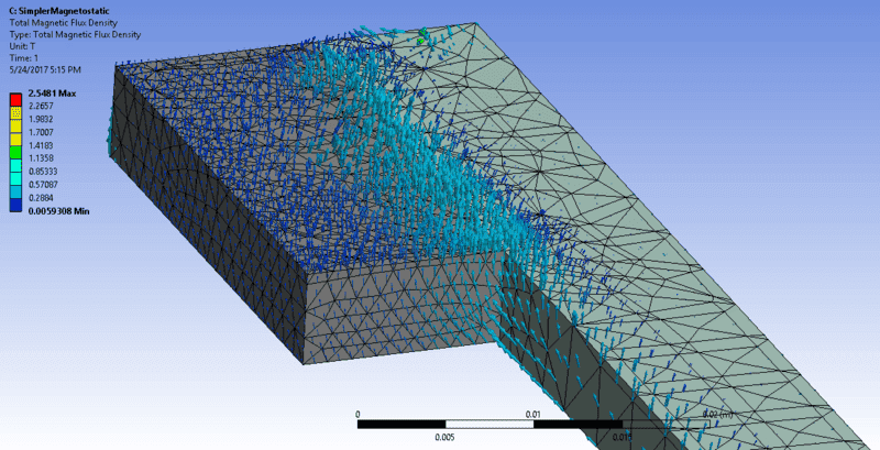

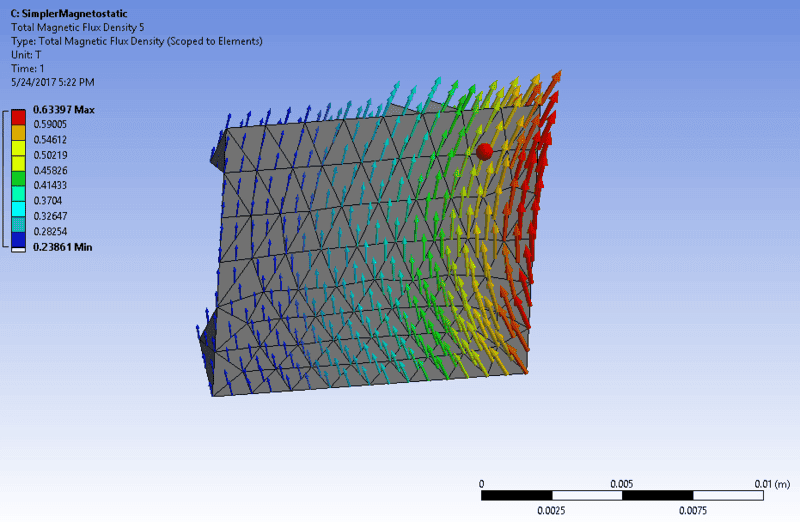

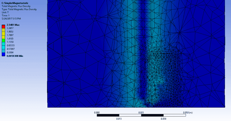

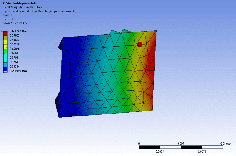

Now, for the part with the pretty plots. I returned to ANSYS (though I didn't get a chance to compare changes in primary parameters) and looked at the case with similar geometry and scale. The results are somewhat similar, but I am getting a maximum B field of ~ 0.86 T (the maximum from one rail is 0.63 T, and the value at the far end is 0.23 T). Not a value of 0.46 or 0.51 like the other calculations got. I don't know how much of an effect the material properties have, so I'm really not sure what to make of this. If I account for material properties in my model, will I get a closer answer? I will try this tomorrow (along with changing the main parameters, and seeing how all the models change with respect to each other).
Anyway, here are the plots. The first, and most informative are of the armature rear face, then I show the whole armature, then the armature and rail, then the armature, rail, and surrounding air.
  • ANSYS contour plot of total magnetic flux density in tesla over a mesh of a rectangular plate, colored from blue at the left edge (about 0.24 T minimum) to red at the right edge (0.634 T maximum).

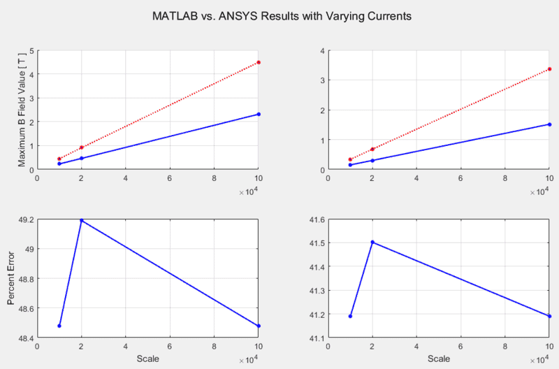

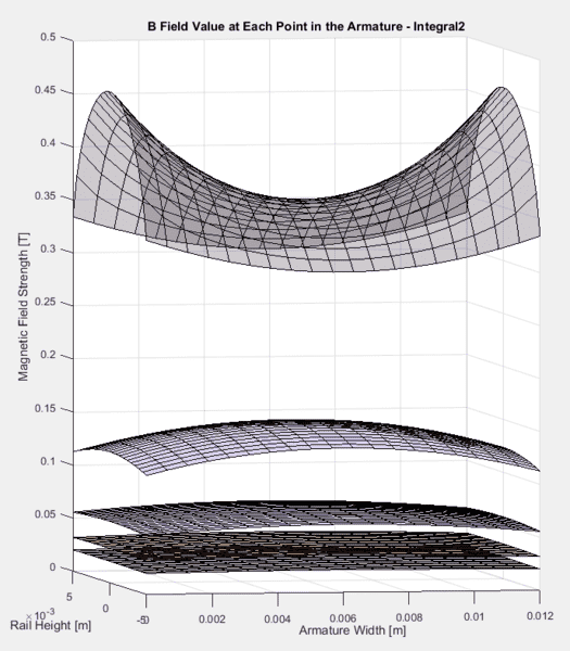

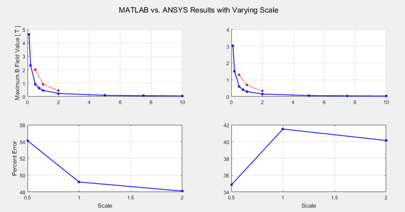

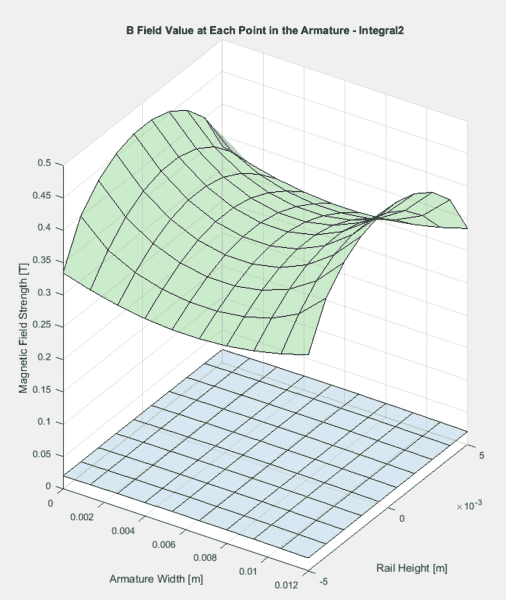

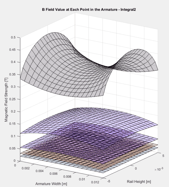

Attached are some plots that show the ANSYS vs. MATLAB results. But more importantly, I've noticed an issue with the shape of the MATLAB results. When plotting these, I plot the magnetic field as a 3D surface where X is the width of the armature, Y is the height of the armature, and Z is the magnetic field strength. Then I plot surfaces for the different armature thickness values (x direction from the paper described earlier, the long direction of the rails) as separate surfaces. As expected, the "deeper" (further away from the armature rear face) into the armature I go, the lower the magnetic field. For the first (top in the plot, on the rear face physically) surface, the shape makes sense. There is a decrease in the center, as this is farther from each rail, and there is a decrease at the top and bottom. This is reasonable because, say, the top of the armature is furthest away from the current flowing through the bottom of the rail. The middle of the armature is closer to both the top and bottom, and should thus have a higher magnetic field. However, the subsequent surfaces have a different shape, and do not fall off in the center of the armature. I thought it possible that there was some adjustment made to the equation I'm using to account for current through the armature (as you were mentioning earlier). But this equation is only for By (B field in the y direction used in the Lizhong et. al. paper), and that current would create no B field in that direction. I cannot figure out the reason for this shape difference, and though the value along the rear face is most important, I'd like to have a computation that actually works. Here is the plot I was talking about showing 5 armature thickness surfaces.
3D MATLAB surface plot titled B Field Value at Each Point in the Armature - Integral2, with stacked surfaces of magnetic field strength in tesla against armature width in metres and rail height in metres; the top surface is grey and wavy, lower surfaces are purple and orange and rise to a central peak.
3D surface plot titled "B Field Value at Each Point in the Armature - Integral2" showing magnetic field strength in tesla against armature width and rail height; the top surface is a curved trough, and lower surfaces are flatter.

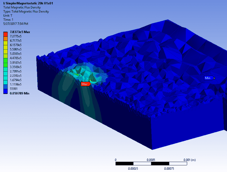

When scaling the model up and down a little bit (0.5x and 2x) I get an inverse linear change in results (all geometric values / 2 gives magnetic field strength increases by 2x). This gives results that are fairly close to twice as large as the MATLAB result (corresponding to the factor of 2 that I have been talking about). The maximum values, and the majority of the overall values seem to follow this trend, but the minimum values do have a bit smaller than 50% error. So it's possible that I'm just looking for a factor of 2 and just seeing it everywhere.
However, when I change the scale to 0.1x or 10x, I get very strange results (which is why these results are left out of the MATLAB plots). Both results have shapes that do not seem reasonable. First, the 0.1x scale plot shows a ball of very high magnetic field in the middle of the armature...I cannot explain this. I'm somewhat willing to ignore it though, since a 0.1x scale would be a 1x1 mm rail, which would never be used in practice. The first plot shows a slice halfway through the height of the armature and rail. The second plot shows a slice through just the armature, which really shows this "swirling" B field. The last plot is the rear fact of the armature, corresponding to an image from earlier, the 10x scale figure below, and the MATLAB plot below that.

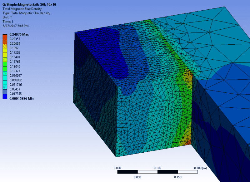

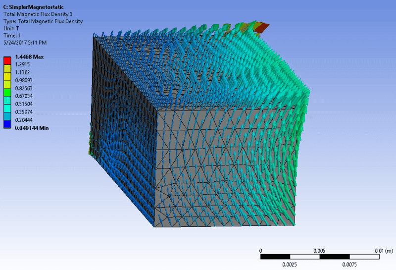

ANSYS contour plot of total magnetic flux density on a 3D rectangular block, colour scale 0.050789 to 7.8373e+05 T, with peak in a localised region near the front face.
ANSYS 3D vector plot of total magnetic flux density in a rectangular armature, with arrows colored from blue (18.508 T min) to red (7.8373e5 T max) and a 0 to 0.001 m scale bar.
Contour plot from ANSYS of total magnetic flux density in tesla on the armature rear face, colour-banded from 8.5239 Min (dark blue) to 876.88 Max (dark red), with the maximum at the bottom centre.
The 10x scale simulation also shows a seemingly incorrect shape, as there is a magnetic field concentration near the top and bottom of the armature. This doesn't make sense as it conflicts with the rationale I described for liking the MATLAB plot above.
ANSYS plot of total magnetic flux density on a thick rectangular conductor, colour contours from 0.00015886 T to 0.24076 T with a 0 to 0.200 m scale bar.
Here is a plot from MATLAB showing the magnetic field strength over this rear armature face for just two thickness values (which I think is easier to look at). If this is compared to the results from my earlier post, it matches up well (the ANSYS result only has one rail, so that explains the lack U shape in the armature width direction). This shape is also followed by the 0.5x and 2x scale cases, as well as the changing current cases.
3D surface plot titled "B Field Value at Each Point in the Armature - Integral2" showing magnetic field strength in tesla over armature width and rail height, with a green curved surface above a flat blue base grid.
...forgot to include the ANSYS vs. MATLAB comparison plots
Four-panel MATLAB vs. ANSYS comparison: top panels plot maximum B field value in T against scale for MATLAB (solid blue) and ANSYS (dotted red), bottom panels plot percent error against scale from 0.5 to 2.
Four-panel figure titled MATLAB vs. ANSYS Results with Varying Currents. Top panels plot Maximum B Field Value [T] against Scale (x10^4) with blue and red lines; red dotted ANSYS values lie above blue MATLAB values. Bottom panels plot Percent Error against Scale (x10^4), ranging about 48.4 to 49.2 on the left and 41.1 to 41.6 on the right.
