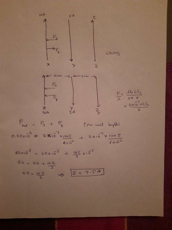

So what additional force must wire Z exert on X to produce the given resultant?
You are given the resultant F/L on wire X. You've calculated the contribution from wire Y. So, what must be the contribution from wire Z? That will tell you the direction of the current in Z and allow you to calculate the magnitude of that current.

As we know a current carrying wire will induce a magnetic field around it. This field will be clockwise around the wire in the direction of current. Both wire Y and Z will exert a force on X.
By looking at the direction of the magnetic field from Y and then Z at the side of X (either into or out of the paper) you can use the hand rules (movement, flux & current) you can work out which way the wire will move.
Using the formula in the attachment you can then calculate the force and hence the direction and value of current in the question.
Considering the figure as it is ,
Force on X due to Y is towards left
Force on X due to Z is towards right.
As net force on X is towards left ( see the attachment ).
F(y) > F (z).
F (net) = F(y) - F( z)
50 x 10^(-5) = 25 x 10^ (-5) - (20xI /6) x 10^(-5)
Solving we get negative value for I which is meaningless . In my opinion it should not be.
So direction of current in Z should be downward.
Then due to both Y and Z forces will be towards X.
  • Handwritten diagram of three parallel vertical wires X, Y and Z, with X carrying 10A upward, Y carrying 5A downward and Z carrying I upward, followed by handwritten force calculations giving I = 7.5A.
