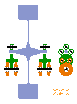

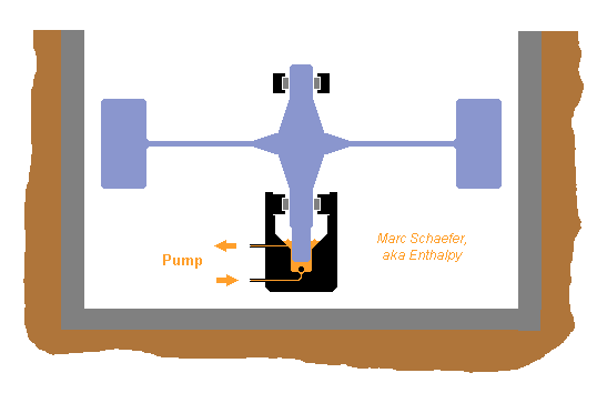

Here a low-loss hydrostatic axial bearing:
saposjoint.net/Forum/viewtopic.php?f=66&t=1974&p=33472#p33178
saposjoint.net/Forum/viewtopic.php?f=66&t=1974&p=33472#p33201

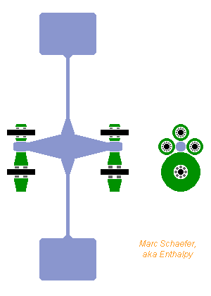

There a low-loss roller bearing for horizontal axis:
saposjoint.net/Forum/viewtopic.php?f=66&t=1974&p=33472#p33263
saposjoint.net/Forum/viewtopic.php?f=66&t=1974&p=33472#p33273

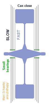

And this shall achieve low loss in normal air:
saposjoint.net/Forum/viewtopic.php?f=66&t=1974&p=33472#p33461

Well then, as the other site limits images to members logged in, here are the sketches of the hydrostatic axial bearings. You may have to click on the images to enlarge them.
And the roller bearings:
And the airflow calmer:

This will happen in normal air, because my airflow calmer reduces losses efficiently (at least according to my computations!). The sketch is in the present thread, in the third message that has drawings. Computations are on the other forum, there

To catch the pieces in case of a mishap, I consider only burying the flywheels. 2m concrete wouldn't stop 20t at 390m/s. For that sake, a vertical axis could be better.

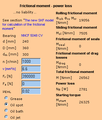

Can you explain how your bearing concepts could lead to products will lower losses than existing hydrostatic and roller bearings? I'm deeply suspicious that adding some rollers can somehow reduce losses. How about fatigue life, misalignment, etc?
As for the air calmer, the air will still have the same average velocity gradient either with or without the disks, so there's still going to be high viscous losses. How did you calculate it?
Judging from the pictures (I haven't gone to your own website) you don't have any idea what is involved in making a safe and reliable device at this scale. For example the cross section of your rotor could be politely described as fanciful, if you actually try doing some stress and rotordynamics analysis on it. There is no way you can make this successfuly out of "standard quality" forged steel. And the only sort of "airflow calmer" that will work is to put the whole thing in a low vacuum.

Unrest, your interrogations about the rollers and the air calmer need and deserve detailed answers, but I'll first go to bed.
For a wheel of OD=5m ID=3.8m L=1.11m that rotates at 28Hz = 1680/min = 177rd/s, or 440m/s at the external radius, I add per side 70 disks spaced by 5mm air. That's many disks, but composite material makes them for cheap - we're talking about a storage unit costing half a million.
Now, speed drop across the 5mm is 6.3m/s only. Air viscosity of 15mm2/s and 18.6µPa*s gives a Reynolds number Re = 2100, meaning a laminar flow. Shear constraint is then 23mPa at R=2.5m; combine with 19.6m2 and an integral coefficient of 0.5 to get a torque of 0.57N*m only. Tripling it for the other side and for the cylindrical face, the power loss is 305W, or over 10h 0.2% of the stored energy, nice. 70*5mm are in fact an exaggeration.
Why add the many disks, as they don't reduce the speed shear?
- They prevent radial eddy flows. Air with a high tangential speed near the wheel feels a centrifugal force which makes it flow outwards there and inwards farther from the wheel. Losses would be 1000 times bigger.
- A bigger speed drop over more distance would enable turbulence, with the usual losses depending on V2 instead of V, again much bigger.
Quite a few, err, engineering details remain open... I suppose the cylinders (which must be necessary) and disks composing a layer can be tied together around the wheel using a thread of high-performance fibre. 5mm spacing over thin parts of 5m diameter may require additional measures, maybe some flexible skis between the layers, that would fly by ground effect.
The flow calmer looks odd? Sure! Because it's new. Being useful to alternators, pumps, turbines beyond the flywheel, it can become as natural in two decades as laminations are now in transformers cores.
Unrest, I'll answer later about the big rollers at the bearings.

I like the airflow calmer idea, seems feasible to me. The bearings, how are you centring the axis in the vertical axis configuration? Did you estimate the losses for the hydrostatic bearing?
Did you estimate the bearing losses, in particular the rolling friction (from deformation of the rollers) ?
edit: on the magnetic bearings... the power wasted in coil (for same magnetic field) grow proportionally to size, but the field energy proportional to size cubed. The force is equal to dE/dx where E is the energy of the system, and that will be proportional to size squared. Meaning that 2x larger electromagnet has 4x the force for 2x the power requirement, so for sufficiently big system you'll be able to suspend the thing under electromagnet, not sure though for energy requirements for the control circuit that is to keep it stable. The motor-generator and bearing could perhaps be combined. I imagine a conical shaped diaphragm with torus-shaped flywheel at the rim, motor/generator/magnetic bearing on the top of the hat, emergency bearing under the top of the hat. Perhaps some permanent magnets and coils along rim to compensate for precession due to Earth's rotation, but i'd think that won't be needed if the hat is always tilted slightly from the vertical. In low grade vacuum because it is going to be inside an underground concrete pit anyway so you could as well add a stainless steel lining on outside of the pit (so that concrete is holding the air pressure) and pump the air out.

More about the hydrostatic bearing depicted in thread #2.
This vertical axis design is centred by two roll bearings, strong enough to hold (actually push) the flywheel during an earthquake, but which operate at very light load usually, hence shall waste little power.
The D=0.12m shaft has only dR=10µm uniform clearance in the cylinder's hole, and oil at 700b lifts the flywheel. No seal adds friction. I suppose simple laminar flows in such a thin gap.
At 174rd/s, 39mPa*s oil produces a shear strain of 41kPa, and over only 5mm fitting height, 800W losses.
700b in 10µm uniform gap produce a maximum leak speed of 4.5m/s and a throughput of 11cm3/s or 800W hydraulic power.
Both added (pump is perfect...) waste over 10h 0.9% of the stored energy.
I don't rely on low-loss roll bearings to centre the shaft in a 10µm gap. In the right sketch of post #2, you see the axial hydrostatic bearing under flexible rods which support the vertical force.
Oil bearings have some self-centring capability, but not necessarily at such a small gap and a small height. Will it?
Height can increase with a lighter oil. I like the small height to give passive stability to the wheel's altitude.
An actuator and a sensor can move the cylinder to follow the shaft if this doesn't occur naturally. Some fitting filled with oil can dampen the cylinder's oscillations then.
The second, external chamber at the sketch minimizes the cylinder's deformation at the fitting.
Some features let me prefer the hydrostatic bearing against the magnetic one. It can be passive, or at least consequences of software failures are more benign. The passive valve in the cylinder gives force for vertical accelerations. If the pump fails, the flywheel touches down gently.
