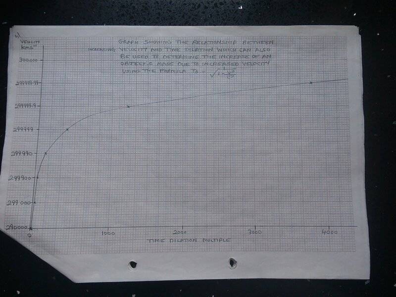

I do get all my information from YouTube videos and by searching the internet and so there is a high probability that I may have misunderstood something, or my calculations may be wrong, but it seems to agree with the ''Boomerang'' results in the conclusion that an accelerating universe is unlikey

Viopia said:
You are choosing just one of the many theories about the expansion of the universe which many people seem to have heard about. Some of these theories are really weird. My evidence is the graph I have plotted (see attached photo). I suggest you read the article, which can be found on Google, entitied ''Does observational evidence indicate the universe is expanding? - Part 1: the case for time dilation'' by John Hartnett''.
Sorry, I'm not interested in what a young-Earth creationist has to say. If you're intent on presenting pseudo-science, you've come to the wrong place.
