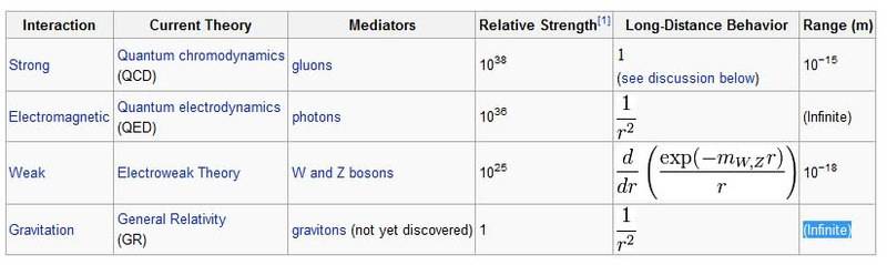

How can G range be infinity ?
I don't understand why you're asking this …
why wouldn't it extend to infinity? why should it stop somewhere? :confused:
General theory of relativity says "Force is consequence of Geometry"
so G range is limited.
GTR says there is no force, only geometry of space-time, which extends everywhere.

Because if the stone is launched from a planet, it will have the velocity of the planet in addition to its launch velocity.I don't understand why you're asking this …
If you are of my age hey BRO !
if you are older than me sir,
look at this .. I don't know why I feel that I found something wrong with sir.isaac Newton's Equation.
I think what you've found is a personal discomfort, nothing more.
