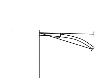

I need to draw a table measuring bendiness but I don't know what unit or how bendiness would be measured.
I have drawn the table up, just I need a unit for bendyness
Well you might have to make one up! How about deflection per unit of force applied. So that would be meters/Newton or cm/Newton or inches/pound or feet/pound.
Okay, this was my initial thought but I'm not sure how well it'll work.
Hand-drawn diagram of a diving board fixed to a block at the left, with a straight dashed line for its original position and a curved bent board ending at a tip, with a tick mark marking the original end.
A line for the original position and length and then one going from the start of that one to the end of the diving board after it's bent.
You could then work out the angle inbetween?

Do you have the deflection of the tip of the diving board from its original position? If so, use that. If not, your idea is perfectly good. After all, it's your graph and what you want to do is to clearly convey information. In this case your effort should be judged on that criteria.
All I have is the weight of the object and the distance it is away from the start of the diving board. The distance is kept constant and the weight's the one changing (Independent variable?)
Okay, so your angle idea sounds good. You could use angle deflection per pound. As I said before all you're trying to do is communicate what's happening and as long as you explain what you mean it should be okay.
