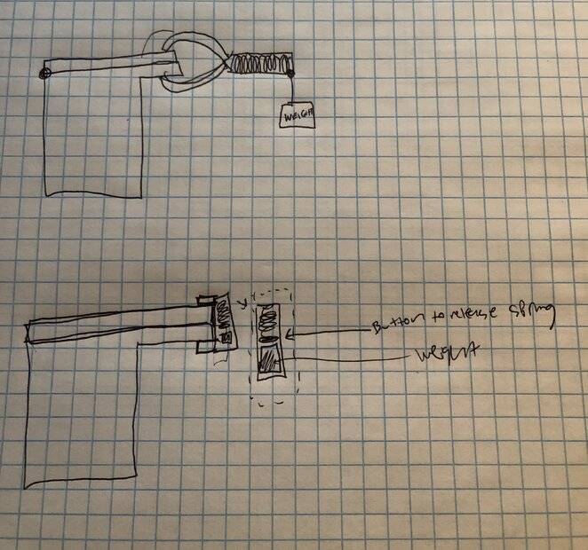

As the TL;DR summary says, I am trying to come up with a design for a lock that unlocks when it is flipped upside down. I've looked into spring loaded locks and different lever devices but no luck. Hoping someone can assist, thank you.

Hi thank you and yes for a class...it is for a bucket. I'd like the top of the bucket to stay locked unless it is flipped upside down.
Okay, let me move your thread to the schoolwork forums then. Can you show us some of your sketches and work on this so far? Use the "Attach files" link below the Edit window to attach some of your design ideas. Thanks.
BTW, are you familiar with the key-tumbler lock design? Normally the pins are spring loaded to resist the key lands, but can you envision a variation on that theme where if you turned the padlock upside-down that would clear the pin obstructions? :wink:
I will research key-tumbler locks. Attached are my first couple drawings... they probably aren't close I will continue trying.
Hand-drawn sketch on grid paper of two lock concepts: top, a bar pivoting from a pin with a coil spring and a hanging weight labelled WEIGHT; bottom, a bar with a coil spring and a block labelled WEIGHT, with a line marked button to release spring.
The idea is when the bucket is turned upside down the lock unlocks an the lid opens freely

So in the simplest terms, this isn't really a lock, it's more of a latch, right? Would you get extra credit for a more complicated "real" lock that needed to be turned upside-down to be unlocked? (like my pin-tumbler-key suggestion above)
Correct it would probably be more of a latch. Possibly a spring loaded latch? Started thinking about incorporating magnetics and ball bearings to maybe have the ball bearing movement release the latch.
Springs and magnetics don't care if they are upside-down. Weighted assemblies do care.
