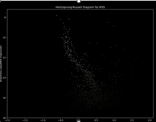

Hi; this is the code I have been given for a H-R diagram of M35; I understand the inversion concept.. The plot is below. I am trying to understand the code that creates its position and size and how to alter it to a more 'acceptable' format please.
Thanks
Martyn

Martyn Arthur said:
I am trying to understand the code that creates its ... size
What, this bit?
Python:
plt.rcParams['figure.figsize'] = [12, 8] # Set figure.figsize to be 12 inches wide and 8 inches high.
What do you mean by 'position'? Are you referring to the way all the data is clustered on the right of the plot? If so then you should be able to work out how to fix that by looking at
Python:
plt.ylim((13, 0)) # Set y axis limits, with the higher number first to invert the axis

Your data is your data and plots correctly on the axes.
xlim() and ylim() are your friends, which makes your plot more centered for viewing while keeping the axes properly labeled.

Thanks;; its an astrophysics course; we aren't expected to learn Python or being taught it. We are just given the Python notebooks to use to plot the data from, on this occasion star clusters which is what has happened, its worked and we have the plot.
Below is a plot of the same cluster Its x axis is -2 and 2 and the outliers to the right are visible.
Could you advise me please the code to set the x scale of my plot to the same levels?
I can get on then with evaluating my plot v the published version (I was required to plot 'just' 130 stars.
Thanks
Martyn
Look at line 22 in the program you posted. That is where the Y-axis (vertical axis) of the graph is defined. The labeling starts at 13 at the bottom and goes to 0 at the top.
22 plt.ylim((13, 0)) # Set y axis limits, with the higher number first to invert the axis
The spot to define the X-axis (horizontal) would logically be in the blank line 23.
I am not familiar with the Python language, but I suspect the format for the X axis would be like line 22 only with "ylim" replaced by "xlim". The numbers would be the horizontal data range of the graph; which you can adjust so the plot includes the range of your data. (Note that negative numbers are allowed!)
Maybe not, but you clearly are expected to work out how to use matplotlib.
Furthermore, because this is a science course you are expected to have an interest in science which includes a natural curiosity for why things are the way they are. We do this by observation and experiment. You can observe that the data is spread fairly evenly along the y-axis which ranges from about 13 to 0. You can also observe that the code includes a line commented as follows:
Python:
So can you think of an experiment to see if you can affect the spread along the x-axis?
