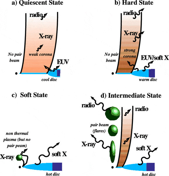

P.S. Here's a cool picture:

Sorry, I don't really follow what you're saying. But, to my knowledge there is no known periodicity of any jets---besides a few cases where there are a few blobs of roughly comparable size. There does seem to be a jet cycle for microquasars, in which the system shifts between hard and soft states: a la
