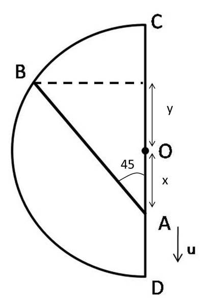

Sorry, i think i did not explain it correctly. My assumption can be better shown by this pic:
Diagram of a semicircular wire with endpoints C and D on a vertical diameter, centre O, and a taut straight string from B on the arc to A on the diameter. The string makes a 45 angle with the diameter; a dashed horizontal line runs from B to the diameter, with segments labelled y above O and x below O, and an arrow labelled u points down at A.
So what i did was incorrect? and why?

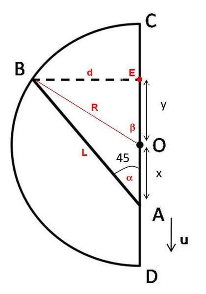

Hi Pranav,
The angles change with time so just call them α and β or anything else. Find relation between them and x. You know that u=dx/dt. The speed of the other bead on the circle is v=R|dβ/dt|. You need to differentiate, using that the length of the cord is constant in time, and so is the radius of the circle.

  • Geometry diagram of a semicircular wire with center O and diameter CD, showing a bead at B on the arc and a bead at A on the diameter. Labels include L for the string from B to A, R from B to O, d horizontal from B to E, x and y along the diameter, angles α and β, a 45 degree marking, and a downward arrow u at A.

As you said i tried finding some relations,
Ist relation, Lsin(α)=Rsin(β)=d
IInd Relation, Lcos(α)-Rcos(β)=x
Differentiating the second relation with respect to time,
Rsin(β)(dβ/dt)-Lsin(α)(dα/dt)=dx/dt
I can use the first relation here but i don't seem to reach the answer.
Instead of using law of sines, why not try using law of cosines.
Diagram of a semicircular wire with diameter CD on the right, a point O at the centre, a point B on the arc, and a straight string from B to point A on the diameter at 45 degrees to the diameter. Dashed horizontal line from B to the diameter; distances y (above O) and x (below O) marked; arrow labelled u points downward at A.
Oh, I see. You had mentioned that the distance of B from O is y earlier, that led me into confusion :-p
I also made a little mistake while saying their vertical components are equal. Instead, their velocities along the rod have to be the same, for no extension.

Pranav-Arora said:
Umm..so what i did is incorrect?
Yes, you got "l=(x+y)cos45"
But it should be [itex]lcos45 = x+y[/itex]
And you cannot simply differentiate this because the angle is changing continuously, as ehild indicated.
How should i proceed now?
An easier approach is equating the velocities of A and B along the rod. Let the velocity of B be v, and then try to solve the problem.

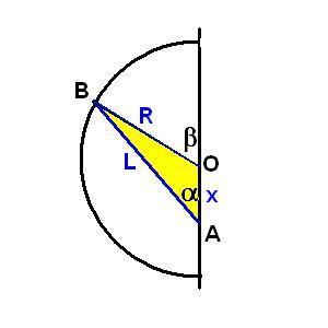

The speed of the bead on the vertical line is dx/dt=u.
The speed of the bead on the circle is v=Rdβ/dt=Rω
From the cosine law in the tringle AOB,
[tex]L^2=R^2+x^2+2Rxcos(\beta)[/tex]
With implicit differentiation,
[tex]0=x u+R u cos(\beta)-Rx\sin(\beta) ω[/tex]
isolating v=Rω
[tex]v=u\frac{(1+\frac{R}{x}cos(\beta))}{\sin(\beta)}[/tex]
Form the sine law, [tex]\frac{R}{x}=\frac{\sin(\alpha)}{\sin(\beta-\alpha)}[/tex]
Plugging in and simplifying, we get:
[tex]v=u\frac{cos(\alpha)}{\sin(\beta-\alpha)}[/tex]
ehild
  • Diagram of a semicircular wire with center O on a vertical line; point B on the arc connects by a straight string to point A on the vertical line, with the triangle AOB shaded yellow. Labels: R (O to B), L (B to A), x (O to A), angle β at O, angle α at A.
