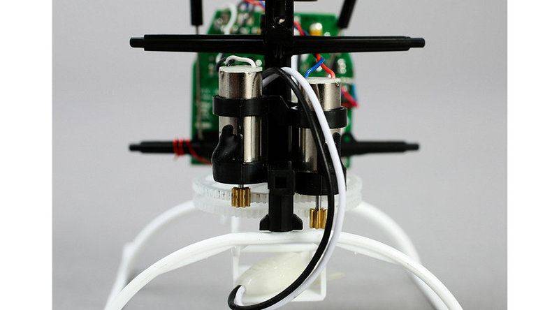

My kids have a small RC helicopter with co-axial contra rotating main lift rotors.
The main drive is a shaft in a tube. One rotor is fixed to the shaft and the other rotor to the tube. There are two electric motors, one motor turns the shaft and it's rotor one way (say clockwise). The other motor turns the tube and it's rotor the other way (say anti clockwise).
The vertical/height axis is controlled by speeding up/slowing down both motors together.
Steering/yaw is controlled by speeding up one motor and slowing down the other. The torque imbalance causes the body to rotate/yaw.

as you said two electric motors with two rotors, can there be the same idea with one motor, like a figure 8 belt or some gears? i want to apply the two different rotations on same shaft and tube like you said with only one motor; does this even exist?
These two photos from the web show how it's usually done. There are two large gears one attached to the tube and one attached to the shaft. Each is driven by a motor and pinion gear...
Close-up of a small model coaxial helicopter's rotor head and drive, with a white plastic spur gear, a silver shaft, a small electric motor on the left, black landing skids and a black blade visible at top.
Close-up of a small toy helicopter's drive assembly showing two black motors with brass pinion gears meshing with a white ring gear, with a green circuit board and black rotor arms above.
