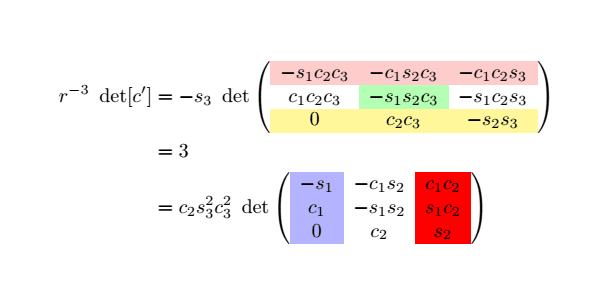

Also, I want to color some of these columns. I found an article relating to this, but I am most confused about the syntax, and how to implement it into my code.
This can be done in pmatrix environment, but it doesn't look impressive. The row color overlaps with the brackets:
If you use the array environment, it looks better:
You need to import the xcolor package.
The code would look something like this:
[CODE title="Using color in table row and column" highlight="3,7,15,17,23"]\documentclass{article}
\usepackage{mathtools}
\usepackage
{xcolor}
\newcommand{\sn}[1]{s_#1}
\newcommand{\cs}[1]{c_#1}
\newcolumntype{a}{>{\columncolor{red}}c}
\begin{document}
\begin{align*}
r^{-3}\det[c'] &=
-\sn{3} \det
\left(\begin{array}{ccc}
\rowcolor{red!20}
-\sn{1} \cs{2} \cs{3} & -\cs{1} \sn{2} \cs{3} & -\cs{1} \cs{2} \sn{3} \\
\cs{1} \cs{2} \cs{3} & \cellcolor{green!30} -\sn{1} \sn{2} \cs{3} & -\sn{1} \cs{2} \sn{3} \\
\rowcolor{yellow!50}
0 & \cs{2} \cs{3} & -\sn{2} \sn{3}
\end{array}\right)\\
&= 3\\
&= \cs{2} \sn{3}^2 \cs{3}^2 \ \det
\left(\begin{array}{>{\columncolor{blue!30}}cca}
-\sn{1} & -\cs{1} \sn{2} & \cs{1} \cs{2} \\
\cs{1} & -\sn{1} \sn{2} & \sn{1} \cs{2} \\
0 & \cs{2} & \sn{2}
\end{array}\right)
\end{align*}
\end{document}[/CODE]
The above code would generate:
To summarise, if you place \rowcolor{red!20} before a row, that row will get coloured. If you want to colour a column, place >{\columncolor{blue!30}} before the column letter in the declaration of array. If you want to colour only a cell, use \cellcolor{green!10} at the beginning of the cell. You can also define a new column type so as to avoid clutter.
See the highlighted lines in the above code.
Feel free to ask questions if anything is not clear.
