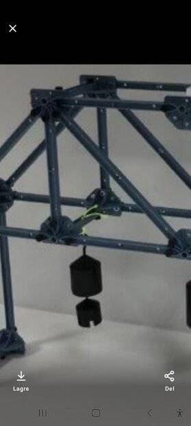

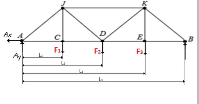

I need to calculate the forces in each of the beams in one of the two equal cross sections of the truss attatched in the picture. The second picture is the cross section of the truss.
As you can see on the 3d picture of the truss the loads are attatched with equal distance inbetween the 2 "cross sections" that make up the truss. When calculating forces in one of the cross sections as in the 2. Picture, do i also need to devide the loads in half as I am only calculating for half the truss?
  • Photo of a blue plastic truss model with rod members and joint connectors, with two black weights hanging from a lower joint on a white surface.
  • Free-body diagram of a planar truss with pin support Ax and Ay at A, roller support By at B, and downward loads F1, F2, F3 at joints C, D, E, with distances L1 to L4 marked along the bottom chord.
Yes, each truss is supporting half of the total hanging weight.
