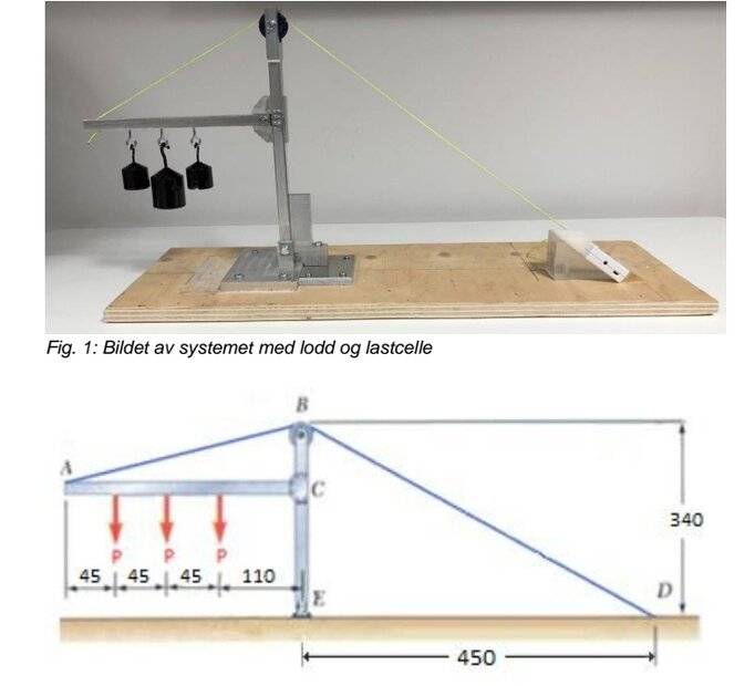

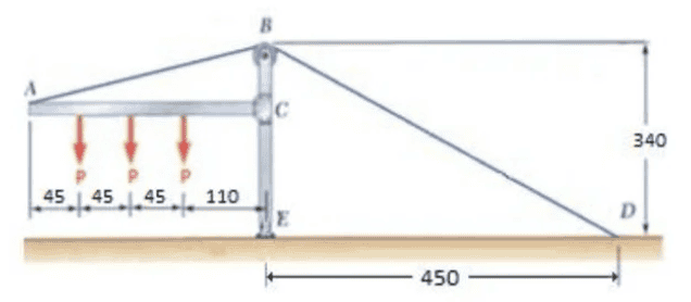

carlcla
Calculate the tension in the rope AD over the smooth pulley B
Moment at E = 0
I really cant wrap my head around how I can find the tension i in the rope going from A to D via the smooth pulley B.
P=4.91N
Distances are in mm
I assume I cant use the triangle EBD as it can be dynamic without the triangle ABC changing. I know I can find the y component of the tension in point A by doing moment at C=0. But I dont get how i can convert that y component into annything usefull without know any of the angles of the rope at A.

E is fixed to the ground with bolts and C is pinned. So C need to have moment = 0
Sorry, I'm not understanding your reply. By "hinged" I mean free to rotate. If E and C are both not free to rotate, the rope is not needed.
Im sorry for the confusion. E is fixed and C is free to rotate.

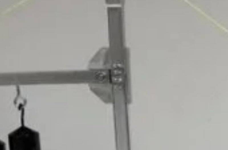

It seems to me that it is the other way around for both, the photo and the diagram.
Note guides reinforced with gussets in junction C, as well as small gap between horizontal and vertical links, that prevents rotation.
Also, the problem wording specifies "Moment at E = 0", which it would only be possible if junction E is a hinge.
If the above is correct, the solution is possible.

Alright lets assume you are correct, that c is rigid and e is a hinge. I still cant see how to solve for the tension. I still end up with too many unkown variables. How would you proceed?
One way to do it is to measure your drawing to get more numbers so you can calculate the rope angle at the left. It's not ideal, but if that's all you've got, then at least you can get an answer to within a few percent.
If C is rigid then the rope on the left side is irrelevant. The leftward-extending arm AC is already rigidly attached. The rope there is not supporting anything. All you have is a needlessly complicated way of tieing off the rope.
Also, if this interpretation (with the hinge at E) is correct then measuring the angle of AB will tell you nothing important.
If the interpretation with the hinge at C is correct then measuring the angle will confirm what you can see by eye: the thing is unstable and no possible tension can hold the assembly in equilibrium.
There is a possible third interpretation. If a hinge at C leaves rod AC free (within the small limits imposed by the guides within which it loosely lies) and if rods BC and CE are rigidly joined as a single anchored vertical post then the rope on the left is relevant and supports rod AC. A measurement can be used to determine the angle of the left hand rope segment AB and thereby infer the rope tension. I do not believe that this is the intended interpretation.

As moment at E = 0, and the armature remains in equilibrium, the counterclockwise rotation of the BE link, that is induced by the three masses (times their horizontal distances to E), must be exactly compensated by the tension in the rope BD.
Yes let me see if I understand you correctly. The the loads times their horizontal distance will be equal to the x component of the rope BD correct? As the y component goes through point E and excerts no moment. What i still dont understand is how to inerprete a smooth pulley wheel such as B. When a rope goes over a smooth pulley that is pointed verticaly such as in this problem. Can the rope excert also an x component on that pulley or only y component (Normal to the pulley)

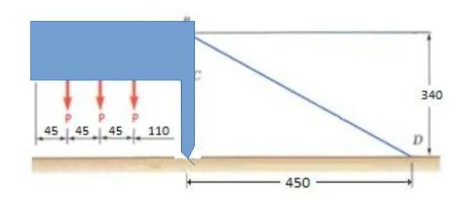

Yes. And to add to what @jbriggs444 said...
The system behaves just the same as if you had a single rigid object (blue object in diagram below) and wanted to find the tension in BD.
The internal structure (of the blue object) doesn't affect the behaviour of the object when external forces and torques act.
Be careful when using this idea though! It wouldn't work if there were a pivot at C because the object wouldn't be rigid. You would need to consider the requirement to have zero net torque about C.
