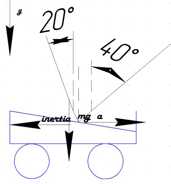

It's open container with water which moves horizontally. It moves with some acceleration. Angle of incidence (α) and angle of reflection(β) on water are given (α=40 deg., β=20 deg.). We need to find container's acceleration.
a=(v2-v1)/t (?)
I've built angles of incidence and angles of reflection for both cases when v=0 and a=0 but what do to further is a big question for me (maybe this way of solution is wrong).
I'll be grateful for the help

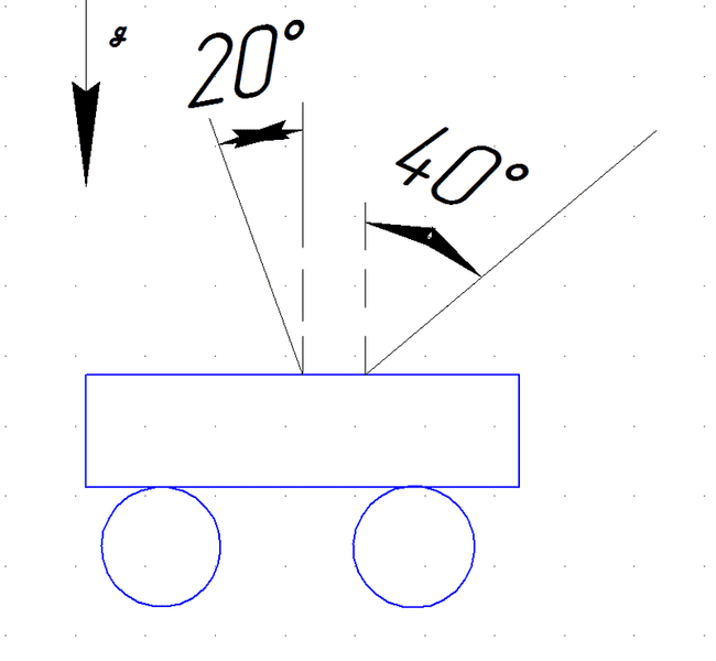

Is this your own diagram or was it provided?
Have you stated the question, word for word, as it was given to you?
I ask because it would be unusual for a horizontally accelerating body of water to have a horizontal surface.

It's open container with water on car. Diagram was provided without vector a

Ok. Distrust the diagram.
Consider a small parcel of water on the surface, or maybe some particle floating there, just submerged. Draw a free body diagram for it. What forces are there? How do these forces account for the acceleration?
Alternatively, if you are comfortable with non-inertial frames, in the frame of reference of the car what are the forces?

It's a copy of diagram and it moves horizontally
this diagram shows the container, not the water surface. Note that the incident and reflected rays are not shown meeting.

There is water inside that container. Yeah, and I can't understand why (how is it possible?).
Acceleration to the left is my supposition
Yes, there is water inside, but the diagram does not show it, so you do not know what the surface looks like.
Please try to answer my questions in post #4.

That looks much better.
Thank you for help!
