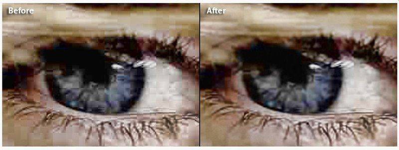

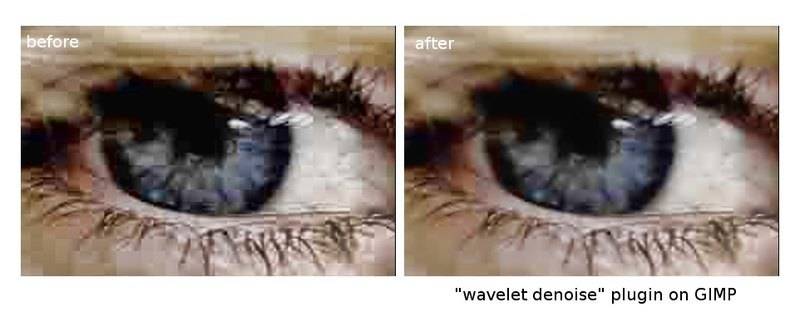

Alternatively ''wavelet denoise'' plugin on GIMP , [GIMP and plugins are free] ...

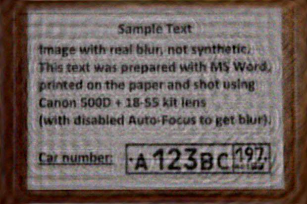

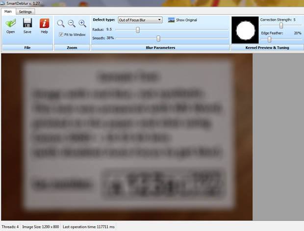

If the brief is to sharpen blurred-text see "SmartDeblur" ...
Before
After
Now readable, but with plenty of artifacts.
Interesting and impressive, but that's not exactly the same thing. If the blur is added in a "systematic" way the information is still in the picture - and it is possible to attempt to recover it. When the image was compressed with the lossy compression situation is different.
