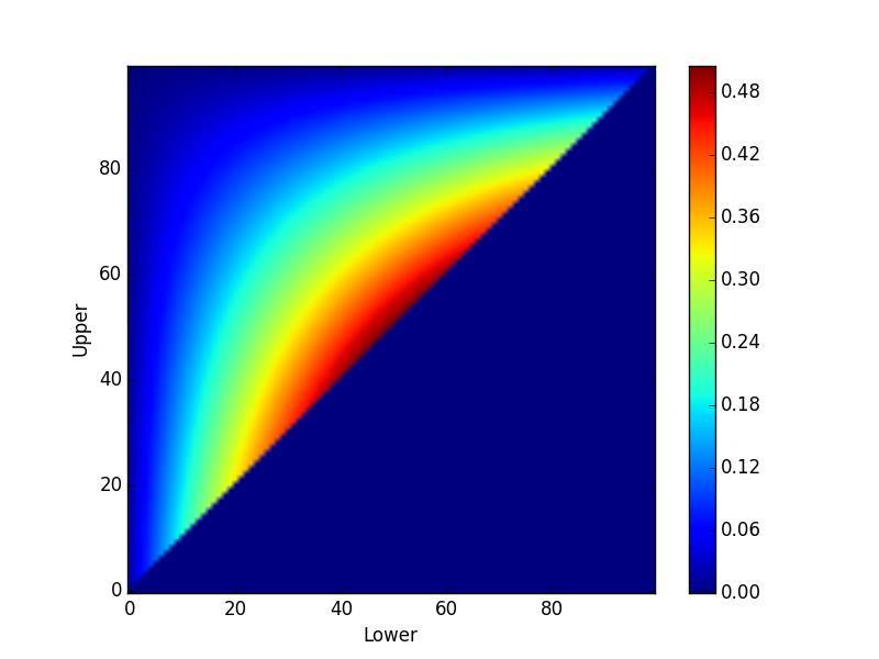

I even made a 2D plot giving the probability ... the x-axis is the player's lower choice, the y-axis is the player' higher choice...
So the most probable victory points for the player have small length/range and the lower value is around 50... and the most probable to win (with about 50% probability) is the player=[50,51]...
