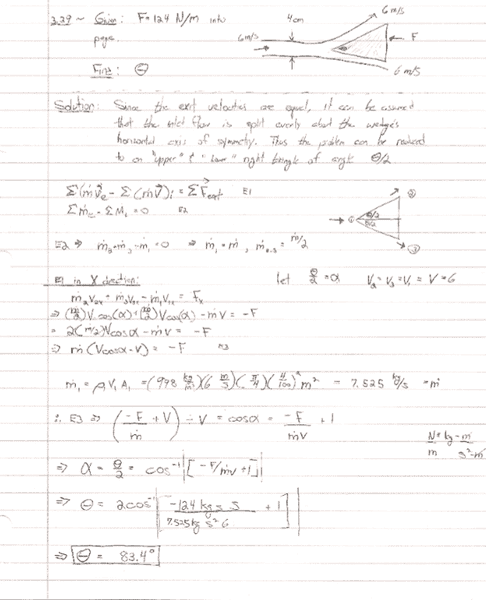

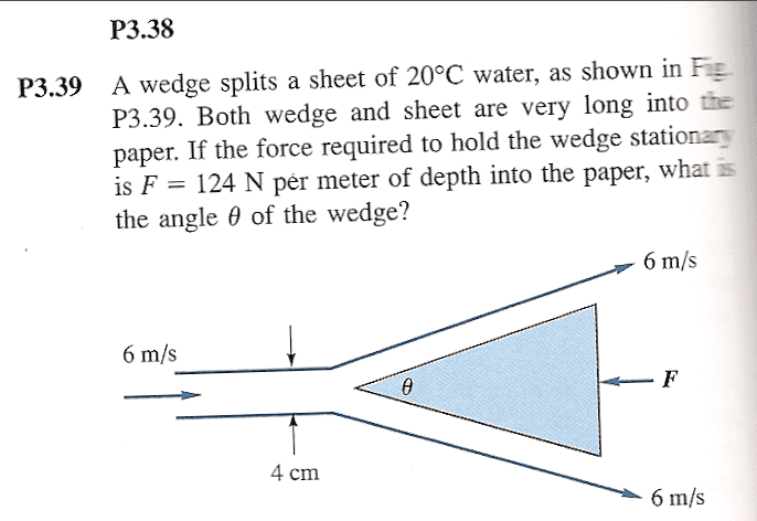

[tex]\sum(\dot{m}\vec{v})_{exit}-\sum(\dot{m}\vec{v})_{inlet}=\sum F_{ext}[/tex]
I only know that this is cons of momentum because my prof told us. I am having a hard time visualizing how to incorporate THETA into the above equation since it is not a nice right triangle.
I am thinking that since the exit velocities are equal, than the inlet flow must be being split about the wedges horizontal axis of symmetry.
Thus, I think I can divide the wedge into an "upper" and "lower" right triangle whose angle wrt to the horizontal is [itex]\frac{\theta}{2}[/itex].
Then I can resolve the momentum eq into Cartesian coordinates.
Sound good?
Sounds lovely!
Nice! I guess that what is confusing me now, is why they gave me
force/unit length into page
But I am just going to start plugging in and see what happens.
Consider it to be an arbitrarily wide sheet of water. Use momentum per unit length as well.
Okay, so the m-1 just drops out anyway, and this problem reduces to regular cons of mom
Yep.
Thanks! 83.4 degrees sounds reasonable I think :smile:
Show how you got that answer.
Rethink your result for m, the mass flow rate. You want it to be mass flow per unit width (or depth).
I am not sure that I follow. Errr... Okay. So that inlet with the 4 cm dimension is NOT a PIPE...right?
It is a "sheet" with area 4cm*WIDTH. Thus my, mass flow rate should be, with h=4cm:
[tex]\dot{m}=\rho V (h*W)\Rightarrow \frac{\dot{m}}{W}=\rho Vh[/tex]
Am I with you now?
Now you're cooking.
Typical 'not-paying-attention' mistake. Perhaps I should turn off Band of Brothers while I do my studies? :smile:
Thanks Doc!
