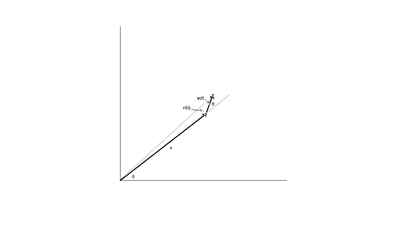

I have an issue with understanding the idea of generalised momentum for the Lagrangian.
For a central force problem, the Lagrangian is given by,
$$L = \frac{1}{2}m(\dot{r} ^2 + p^2 \dot{\phi ^2}) - U(r)$$
with ##r## being radial distance.
The angular momentum is then,
$$P_{\phi} = \frac{\partial L}{\partial \dot{\phi}} = mr^2\dot{\phi}$$
Without the Lagrangian, I would have started with,
$$P_{\phi} = \vec{r} \times \vec{P}$$
$$|P_{\phi}| = rP\sin (\theta)$$
$$|P_{\phi}| = rmv \sin (\theta)$$
with ##\theta## being the angle between the two vectors, which I think can be reduced with the equation
$$v = r\dot{\phi}$$
and angular momentum is,
$$|P_{\phi}| = mr^2 \dot{\phi} \sin (\theta)$$
which varies significantly.
Could someone kindly
a) Explain the errors in my assumptions
b) Explain how I should have altered my "Newtonian" working in order to derive the same result as the Lagrangian method?
Thanks!
v = rφ' is true only when the v and r vectors are perpendicular, as in circular motion. More generally, rφ' = v sinθ.
Hi, thanks for the response.
But this means that the particle in the Lagrangian problem has to be moving in a circular motion, which needn't be the case, no?
No, the Lagrangian is general (as shown by the term in r'2, which is 0 for circular motion.)
Do you mind explaining why ##v\sin \theta = r \dot{\phi}##?
Thank you.
Hope this helps
mjc123 said:
Hope this helps
If you want to compare those two ways of calculating the momentum you need to express ##\vec{r} \times \vec{P}## completely in terms of ##r## and ##\phi## and their derivatives. Putting in the extra angle ##\theta## makes it hard to compare them.
