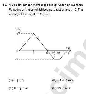

How Do I Interpret This Graph for Homework?
  • Thread starter Thread starter sidt36
    Graph
10 replies · 2K views
sidt36
36
So should i take the area under the graph or something
And is in the future i Tackle such problems what are the key thing to remember[/B]
Tried subtracting the areas no use xd[/B]

Well, what do you know about how force relates to the motion of an object?
Trying random things with a graph rarely leads to anything useful, unless you know something about the physics of what is going on.
