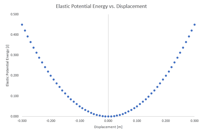

Good afternoon,
I have a question on graphing this problem. There seems to be something weird going on.
In Excel, I set up the potential energy function (kx²/2) and plotted it from x = -0.300m to 0.300m, which looks like the following:
Scatter plot titled Elastic Potential Energy vs. Displacement: a parabola of points with energy in J on the y-axis (0 to 0.500) against displacement in m on the x-axis (-0.300 to 0.300), reaching about 0.450 J at both ends and near 0 at the center.
The overall shape of the graph looks like what's expected, but the energy values at the displacement extrema don't match the total mechanical energy given by the provided initial and final energy values. My graph returns 0.450 J, whereas the total should be 0.200 J (from the given 0.140 J + 0.060 J).

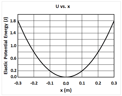

To make matters worse, I've tried looking this up online, and it appears that many different sources have just blatantly copied the graph from the solution manual with zero explanation:
Graph titled U vs. x of elastic potential energy in joules against x in metres from -0.3 to 0.3, a parabola with minimum 0.0 J at x = 0 and 1.8 J at x = ±0.3.
Why is there such a significant difference between these two graphs in regards to the y-axis?
Further, how is it that the maximal potential energy (which would be equal to the total mechanical energy)
is 1.8 J, instead of 0.200 J?

The result at the extremes should clearly be ##10 \cdot 0.3^2/2 = 0.9/2 = 0.45## J.
The suggested graph is just wrong. Perhaps from erroneously multiplying by 2 instead of dividing by 2?

That's not the issue. The total energy is E = 0.200 J. This means that the amplitude of oscillations is $$A=\sqrt{\frac{2E}{k}}=\sqrt{\frac{2\times 0.200~(\text{J})}{10.0~(\text{N/m})}}=0.200~\text{m}$$ The oscillator does not have the energy to reach ##\pm 0.300~##m.
OP's plot looks correct but the plotted points should stop at ##\pm 0.200~##m.
100% agree with the energy at the extremes being 0.45 J and the amplitude of oscillations being 0.200 m. Totally matches everything I have, thank you for verifying that.
Even within the valid bounds of oscillation, there's some weirdness going on. In the 2nd graph (the one some sites copied from the solution manual), they have the potential energy being equal to 0.800 J at x = +/- 0.200 m.
Using kx²/2, I get 0.2 J. Very strange! I'm at a loss as for how they get a result a factor of 4 larger.
As I said, probably by mistakenly multiplying by two instead of dividing.

The way I read the question, there are two parts. In the first part you draw a graph for a given range of the displacements which could occur. This you did correctly, whereas the solution manual and some online solutions overstate the PE by a factor of four.
In the second part, an actual oscillation is described. In this, the total mechanical energy is 0.2J. But what is the question?
