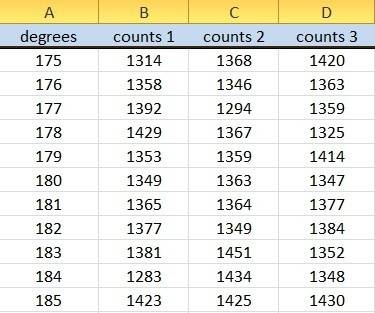

I have this set of data (in the attached image) and I'm trying to normalize the counts at each angle to a maximum of 100. I'm not sure how to do it though. Any tips would be much appreciated.
I have the mean and std dev for each count at each angle. I don't really know what to do from here though...
  • Spreadsheet table with columns labelled degrees, counts 1, counts 2 and counts 3, listing integer counts for degrees 175 to 185 in rows.

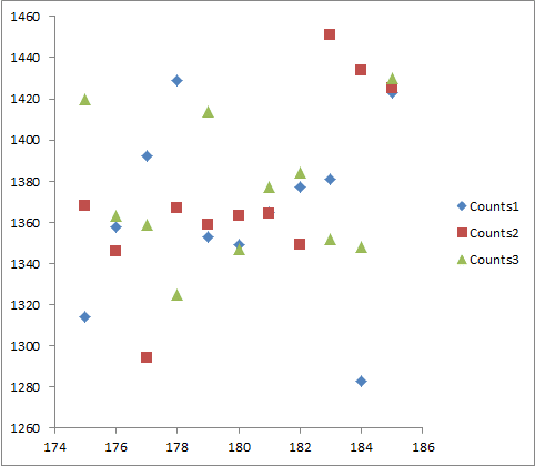

You should have a very good reason to divide all observations by 1451 (which does what you say you want to do). Such an action mixes up all 33 observations with one single result (that has an error of itself and on top of that appears to deviate from the pattern -- an outlier candidate !).
Scatter plot of three series, Counts1, Counts2 and Counts3, against values from 174 to 186 on the horizontal axis, with counts roughly 1260 to 1460 on the vertical axis; one red Counts2 point near 1451 at x = 183 stands apart from the rest.
Could you tell us a little more ?
The data represents the number of counts at each angle. So at 175 degrees we measured counts of 1314, 1368, and 1420.

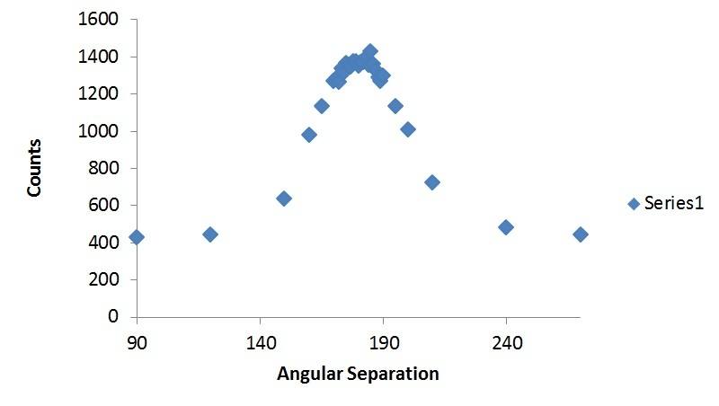

I've taken the mean of the counts and then plotted the angle vs. mean counts. I want to normalize this to a maximum of 100 though
  • Scatter plot of Counts against Angular Separation, with points from about 90 to 270 degrees; counts peak near 1400 around 185 degrees and fall to about 430 at 90 and 270 degrees.

Aha, there's a bit more data and what you are trying to do is fit a peak in some spectrum ?
Could you explain why you need the 100 maximum ?
More questions: how accurate is your angle determination ?

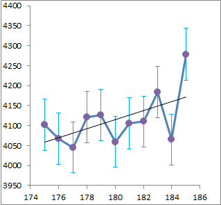

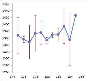

By averaging you effectively add up the individual measurements. Left figure is average with error bars from (only) three measurements. Right figure is sum with error bars from Poisson statistics (##\sigma=\sqrt(N)##).
Line graph with purple dots joined by a blue line, red and purple error bars, x-axis 174 to 186, y-axis 1260 to 1460; values rise from about 1370 to a peak near 1425 at x=185.
Line graph with purple markers joined by a thick blue line, with vertical error bars and a thin black linear trend line, plotting values from about 4050 to 4280 against x from 175 to 185.
The red error bars are not very meaningful: the relative error in a standard deviation from N=3 is huge (theoretically ##1/\sqrt{N-1\ }## but that is for N >> 1).
The blue error bars are simply ##\sqrt N## where now N is the number of counts, so all are 64. A linear relationship easily catches 10 out of 11 measurements -- but that was before you showed a wider range of angles. So: forget the linear trend line (you 'wrong-footed' us by only showing a small part of the data :wink:).
Now a core question: do you have a 'model' line shape ? A theoretical expectation like a gaussian or a lorentzian ?
  • Line graph with purple markers joined by a thick blue line, vertical error bars, and a thin black linear trend line; x-axis 174 to 186, y-axis 3950 to 4350, values rising overall.

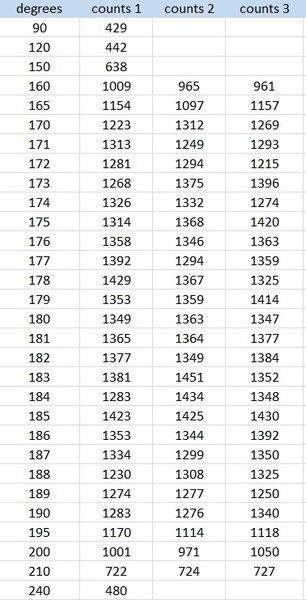

Sorry, I didn't realize I'd cropped my image of the data incorrectly. I've attached the rest of it to the image below. The data fits a gaussian curve.
One of my count rates was for 10 seconds. The other was measured in counts per second. If I can normalise both to a maximum of 100 i can compare and contrast both results.
  • Spreadsheet table with columns degrees, counts 1, counts 2 and counts 3, listing degrees from 90 to 240 with corresponding count values, where counts 1 peaks near 1400 around 170 to 180 degrees.

Don't forget the background ... So you have four parameters to adjust: ##\bar x, \ \sigma,\ ## N and C (peak height and background).
