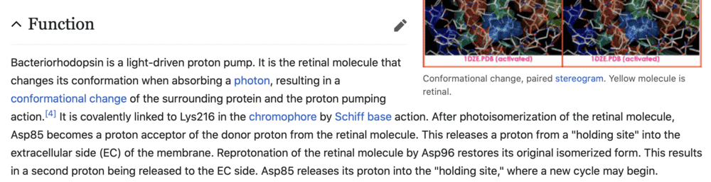

Another question I always had in biochemistry was "how does absorption of a photon lead to conformational changes of the protein? After reading this page I was reminded of my question. Since then I took classes in inorganic chemistry and physics. The process could be: when an electron absorbs a photon within the right range of wavelengths, the electron gets excited and occupies a higher molecular orbital that has a different geometry than the orbital occupied by the ground state electron. This change in geometry leads to a change in electromagnetic repulsive forces exerted by the electron on the surrounding, and thereby the local conformation of the protein changes slightly. Does this sound crackpotty?

For rhodopsin proteins (such as bacteriorhodopsin or the opsin proteins that underlie our own vision), the proteins contain a molecule called retinal that can undergo a cis-trans isomerization upon the absorption of light. The change in shape of the retinal molecule propagates to the rest of the protein, causing the protein to change its overall shape. So, photoisomerization of a small molecule underlies the conformational change of the entire protein.
After reading your explanation, I did a quick google search and found this nice description of photoisomerization of a molecule called azobenzene using molecular orbital theory. It's a compelling picture.
