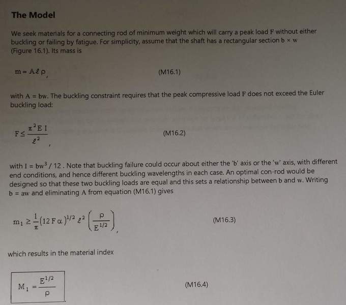

How Do I Solve for w2 in a Con-Rod Performance Index Problem?
  • Thread starter AutoDude123
    performance
1 reply · 1K views · last reply
AutoDude123
Please see the attachment for the question, thanks
Also given in attachment
After eliminating A, I have a w2 term which I cannot eliminate and my l term is cubed and my ρ term is not squared. If anyone can guide me through step-by-step, that would be great.
Thanks!
  • Printed page titled The Model with equations M16.1 to M16.4 for a con-rod: mass m = A l rho, buckling constraint F <= pi^2 E I / l^2, and material index M1 = E^(1/2) / rho in a box.
Can you show your work up to the point where you get stuck?
