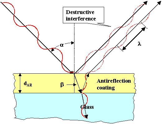

From what I know, to make interference happen, it must be two waves in phase that move into same direction.
In this model, they show one wave that reflect two times, and each is interfering with each other, and cancelling each other (destructive interference).
But only one wave is passing through the glass. How does it interfere with another wave to make a constructive interference?
Ha ha, you have asked the question that challenges the simple explanation. There are in fact many reflections between the layers and the 'through' ray is enhanced by interference from the other internal bounces, resulting in all (most) the light being transmitted. The layer has the effect of cancelling all reflections from both surfaces. If the angle of incidence is not zero then this process will not work as well and this will result in a colour caste of the surface as some wavelengths are reflected more than others.
My (simpler) original point about the Conservation of energy (this has to happen) justifies the principle in that no reflection from the first face must mean total transmission.

Not in general, no. Two different waves will interfere with each other when they overlap, regardless of the direction of propagation. The amplitude of each wave is added together and you get either constructive or destructive interference depending on if the sum is larger or smaller than the amplitude of either wave.
The reflected portion of the initial wave is itself another wave. So in total you have 3 waves in that picture, not just one. It's just that two of the waves undergo destructive interference and have near-zero amplitude in the backwards direction. As for the constructive interference I mentioned in my post, I confess I don't know much about that. I was mostly seconding Khashishi's explanation.
Also, keep in mind that you're looking at an extremely simplified picture of the process. In real life there will be an entire wavefront, not just a single ray, and there will be multiple reflections and other issues that arise.
