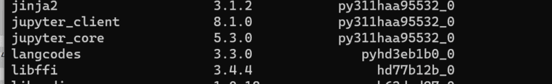

But I can. I didn't install jupyter lab via pip or conda. However, when typing conda list, I see that there is a jupyter_client and jupyter_core installed:
That might mean, as I said, that Anaconda installed these things automatically, without your having to tell it to. Or it might mean that you are using versions of these things that are installed elsewhere on your system, not in the environment. That depends on whether or not the environment was activated when you ran the script. See below.
