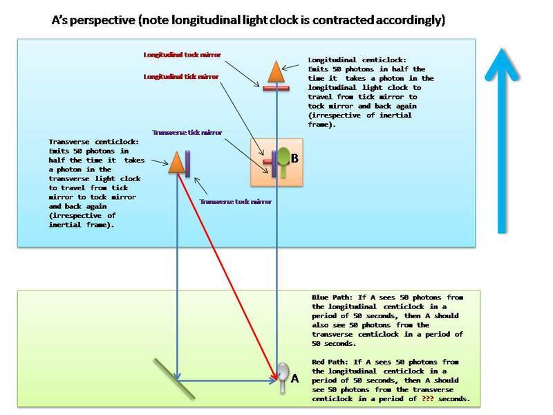

I put together a diagram, since I am a visual sort of guy.
The parallax error I meant was due to the offset of the tock mirror of the transverse light clock. If you consider A a baseline, rather than a point, then the whole clock moves away from the baseline at a constant rate (the minimum distance between a point on the light clock and the nearest point on the baseline will increase at a constant rate). Because we usually consider A as a point, there won't be such a constant rate - eventually, when the distance between A and the transverse light clock is sufficiently great, there will be effectively no parallax error.
Alternatively, you can use the arrangement in the diagram, which overcomes this "parallax error".
Note that there is a question in the bottom right had corner of the diagram.
I think that ? will tend towards 50s - at first it won't be, because of "parallax error", but as separation -> infinity, ? -> 50s.
Is that right?
Is that right?
By "parallax error" do you mean the fact that the tock mirror of the transverse light clock is not moving in a straight line away from A, so that its velocity away from A is changing, and thus if we allow the centiclock to turn on and off repeatedly the time that A sees the centiclock being on for will be changing too? If that's what you're getting at I agree, for example I found above that if the transverse centiclock turned on at t=0 and off at t=25, then A would see it turn on at t=20 and see it turn off at t=50, a visual period of 25 + 5 = 30 seconds; but if the centiclock turned on again at t=50 and off again at t=75, then since the distance at t=50 is [tex]\sqrt{0.6^2*50^2 + 20^2}[/tex] = 36.055513, and the distance at t=75 is [tex]\sqrt{0.6^2*75^2 + 20^2}[/tex] = 49.244289, that means A will see the visual period as 25 + (49.244289 - 36.055513) = 25 + 13.18878 = 38.18878 seconds, which is somewhat larger. More generally, if the centiclock starts at time T and stops at time T+25, then the visual period will be [tex]25 + \sqrt{0.6^2*(T+25)^2 + 20^2} - \sqrt{0.6^2*T^2 + 20^2}[/tex] = [tex]25 + \sqrt{0.36*(T^2 + 50T + 625) + 400} - \sqrt{0.36*T^2 + 400}[/tex] = [tex]25 + \sqrt{0.36T^2 + 18T + 225 + 400} - \sqrt{0.36T^2 + 400}[/tex] = [tex]25 + \sqrt{0.36T^2 + 18T + 625} - \sqrt{0.36T^2 + 400}[/tex], and plugging this expression into the limit calculator and taking the limit as T approaches infinity (type 'inf' into the 'compute at' box) gives an answer of 40, or 25 + 15 seconds. This is the same as the visual period of the longitudinal clock, which makes sense since the further away the transverse centiclock gets, the closer it gets to just moving radially outward at 0.6c just like the longitudinal centiclock, so in this limit you should be able to use the same Doppler shift formula. But yes, this means that if you have set the period of the longitudinal centiclock such that A receives signals from it at a rate of 1 per second, then in the limit as the distance of the transverse centiclock becomes large, A will also receive signals from it at a rate arbitrarily close to 1 per second.
So it seems we are in agreement.

For anyone who is interested as to why I find the previously posted link interesting, the composite authors of that article effectively draw upon temporal contraction. Probably there are other better derivations of the relativistic doppler effect which don't do so.
I asked about a doppler consideration for length contraction because I was wondering if time dilation is the combined effect of doppler effect and this temporal contraction. I fiddled with the figures and at first blush it doesn't seem to.
I'd prefer to stick with the temporal analogue for length contraction explanation discussed in an earlier thread ("bump"). I imagine that this is what is being used in the wikipedia article.
I would say that in that instance they're using what I called the "reversed time dilation equation", i.e. the regular time dilation equation with both sides divided by gamma. They were first calculating the time t between wavefronts hitting the observer in the frame of the source, so this is the time between two events that are not colocated in this frame; then they were using this to find the time [tex]t_0[/tex] between the same two events in the frame of the observer, where they both happen at the same position since the observer is at rest. The "regular" time dilation equation is:
(time between events in frame where they are not colocated) = (time between events in frame where they are colocated) * gamma
Which in these terms would be:
[tex]t = t_0 * \gamma[/tex]
So, just divide both sides by gamma and you have the equation in the wikipedia article:
[tex]t_0 = \frac{t}{\gamma}[/tex]
In contrast, if they were using the "temporal analogue for length contraction" they would be calculating the time [tex]t_0[/tex] in the observer's frame between surfaces of simultaneity in the source's frame which have a separation of t in the source's frame--I don't think it makes much sense to interpret it that way.
