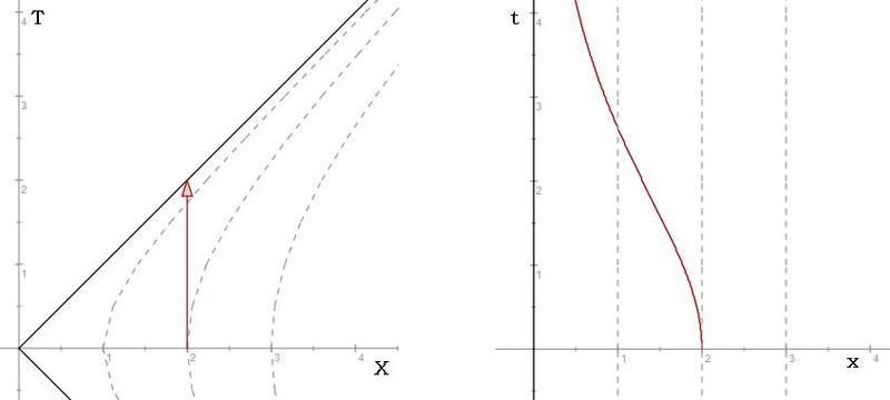

This is an analysis of how a classic Einstein light clock behaves when accelerated orthogonal to its main axis. The results might be considered slightly controversial, so I am putting the details of the calculation here so that they can be checked.Consider a light clock that has its long axis parallel to the y-axis that is being accelerated in the x direction as per this diagram:
https://www.physicsforums.com/attachment.php?attachmentid=62152&stc=1&d=1380051964Let the emitter end of the light clock start at x=y=t=0 and accelerate with constant proper acceleration g.
At times t1, t2, t3 the light clock is at x1, x2, x3 respectively. To find the round trip time of the photon (or the time of one tick of light clock) we need to find ##(\Delta t_2 + \Delta t_1) = (t_3-t_1) ##
Given t1 we can find t2 starting from the obvious Pythagorus relationship:
##L^2 + (\Delta x_1)^2 = c^2( \Delta t_1)^2##
##L^2 + (x_2-x_1)^2 = c^2 (t_2-t_1)^2##
Using the equations of relativistic accelerating motion given http://math.ucr.edu/home/baez/physics/Relativity/SR/rocket.html the spatial coordinates can be expressed in terms of the time coordinates via the relationship (using units such that c=1), ##x =\sqrt{1/g^2 + t^2}## giving :
##L^2 + \left(\sqrt{1/g^2+t_2^2}-\sqrt{1/g^2+t_1^1}\right)^2 = (t_2-t_1)^2##
This can rearranged to give t2 in quadratic form:
##t_2^2 - t_2*t_1(2+L^2g^2) + (t_1^2- L^4g^2/4 - L^2) = 0##
and solved in the usual way to give:
##t_2 = t_1(1+L^2g^2/2) \pm \sqrt{t_1^2((1+L^2g^2/2)^2 -1) + L^2(1+L^2g^2/4)}##
There are two possible solutions. When the sign of the second term is positive t2>t1 and when it is negative t2<t1 so the positive term is chosen. (Note that by swapping t2 for t1 and vice versa we can find t1 using the solution with the negative second term, if we are given t2.)
The above expression is generic and we can find t3 by substituting t3 for t2 and t2 for t1 in the above expression:
##t_3 = t_2(1+L^2g^2/2) + \sqrt{t_2^2((1+L^2g^2/2)^2 -1) + L^2(1+L^2g^2/4)}##
The above calculations show that given t1 we can find t2 and t3 and therefore the round trip time (t3-t1). We can find t1 given any initial conditions such as initial position x1 or initial velocity v1 at the time the photon is emitted at the start of a tick, using the relativistic equations of accelerating motion, given in the link above.
The round trip time (t3-t1) is the coordinate time in the initial inertial frame. The time interval of the light clock (its tick rate) according to a comoving (accelerating) observer is given by:
##(t_3' - t_1') = (1/g)\left(\sinh^{-1}(g*t_3) - \sinh^{-1}(g*t_1)\right)##
Assuming I have done the calculations correctly, the proper frequency of the light clock does not keep time with a co-accelerating ideal clock. The equations are time dependent and therefore also dependent on the instantaneous velocity or position of the clock. This is a slightly curious result, and demonstrates that while the ruler length of a measurement orthogonal to the direction of motion is constant and not subject to length contraction, the radar length is constantly changing, (except for the special case when g/c=1). It turns out that when g/c<1 the frequency of the light clock increases with increasing velocity and conversely the frequency slows down with increasing velocity of the light clock when g/c>1.
Before anyone gets too excited and thinks the accelerating light clock indicates absolute motion, bear in mind that it only records its velocity relative to the time it started accelerating. If the light clock stops accelerating and starts again it restarts from v=0. Effectively it does nothing more than multiplying the output of a traditional accelerometer by the elapsed time to estimate the instantaneous velocity.
Anyway, I won't dwell too long on the implications of the results found here, just in case I have made a glaring mistake. Hopefully someone here will do the honours and check the calculations.
P.S. From some old discussions on PF, we know that a light clock that has constant proper acceleration parallel to its main axis (undergoing Born rigid motion), does maintain constant proper frequency. It follows that a Michelson-Morley type arrangement of two light clocks at right angles to each other will show an interference fringe shift under constant proper acceleration. There is no reason to think that a MMX type arrangement would show a fringe shift when stationary in a gravitational field due to the acceleration of gravity.
This is an interesting exception to the equivalence principle which is not due to tidal effects. How does a light clock distinguish between acceleration in flat space, which causes an actual change in location and velocity, and gravitational acceleration when there is no actual change in location and velocity relative to the gravitational field?

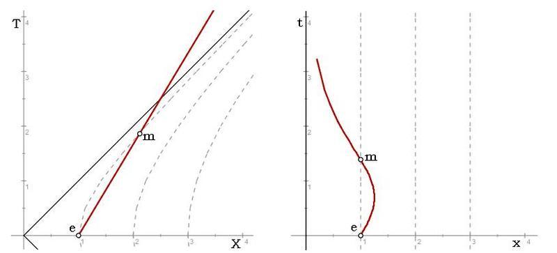

I don't know where the rocket equations you linked to come from. I've done this instead.
The acceleration is 1/x in the x direction. The light clock extends into the y-direction at constant x.
Using ##ds^2=x^2\ dt^2 - dx^2 -dy^2 - dz^2## with ##ds^2=0## we get ##x_0dt = dy## (for some fixed ##x_0##). For a clock following the stationary (or comoving) worldline ##u^\mu=\partial_t/x## we get ##d\tau=x_0dt##. Combining this with ##x_0dt = dy## gives ##d\tau = dy## which on integration gives ##\tau=y_2-y_1##. Which, I think, shows that the light clock will tick as the same rate as any other clock at ##x_0##.
I agree that your calculation is correct. I think the disagreement in our conclusions comes about because in your method, the photon is traveling precisely along the y-axis of the accelerating reference frame, while in my method the photon follows a curved path in the accelerating reference frame. In my method the photon only travels a straight path in the Minkowski frame. This straight path transforms to a curved path in the Rindler frame and does not remain on the y axis. I think this is what jartsa was alluding to when he said the photon takes a route that spends more time at 'high altitude'.

OK, I have found the problem, thanks to the input from Ibix. All the calculations in the OP are correct as is the alternative more compact version given by Ibix. The bug was in my spreadsheet.
Now the frequency of the accelerating light clock is not time (or velocity) dependent, but the radar length is generally shorter than the ruler length. This seems to confirm the idea that the photon in the clock is traveling along a curved path in the accelerated frame, so it is not tracking exactly along the y axis. I assume this is why the discrepancy between radar length and ruler length does not show up in Mentz's method.
Thanks guys for all the input. Problem solved (I think). :smile:

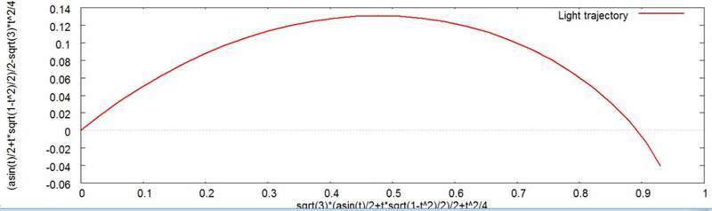

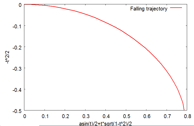

I hope yuiop won't mind me posting this question here because it's related to the accelerating light clock. I'm trying to find the null geodesic that starts at (x0,y0) in the y-direction and intersects y=L at (x1,y0+L) . The metric is ##ds^2=-a^2x^2dt^2+dx^2+dy^2+dz^2##. Starting with the Lagrangian
##\mathcal{L} = -a^2x^2 \dot{t}^2 + \dot{x}^2+\dot{y}^2## where the dot means d/dλ, λ being an affine parameter. The Euler-Lagrange equations for x are
##\frac{\partial \mathcal{L}}{\partial x}=-2a^2 x\dot{t}^2## and ##\frac{d}{d\lambda}\frac{\partial \mathcal{L}}{\partial \dot{x}}=2\ddot{x}## so ##\ddot{x}=-a^2\dot{t}^2x##.
Because ##\mathcal{L}## does not depend explicitly on t, y nor z, ##\ddot{t}=\ddot{y}=\ddot{z}=0##.
Applying the constraint that this is a null geodesic, ##\dot{x}^2+\dot{y}^2=1## we can write ##\dot{t}^2=1/(ax)^2## so that ##\ddot{x}=-1/x##. Integrating this gives ##\dot{x}=\lambda(1/x_0-1/x)##.
This looks like ##v=at## which is what I'd expect on a time-like trajectory but not a null one.
At this point I'm stuck. How did I go wrong ?

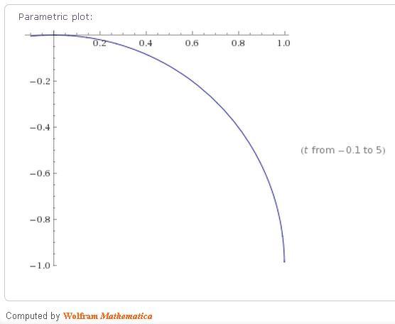

I only skimmed the work, but my first thought is that you assumed that light travels in a straight line. This is only true in inertial coordinates.
What I think you need to compute would be called in optics the "optical path length", to do this I would suggest first to compute the curve that the light actually follows (which will be a null geodesic).
You can get this from the metric, but the path will be a null path, so it won't have a direct length you can compute via the Lorentz interval.
Wiki says http://en.wikipedia.org/wiki/Optical_path_length
n optics, optical path length (OPL) or optical distance is the product of the geometric length of the path light follows through the system, and the index of refraction of the medium through which it propagates.
You can get the "index of refraction" from the metric for an accelerated obserer. Unlike any normal optical material, the effective index of refraction is going to be greater than 1.
I haven't carried through this calculation, or even thought of it much, so I might be missing something or even making a conceptual error. This is my current thinking though.
Intuitively, light will follow an approximately parabolic path. You'll have to angle the beam upwards. As the floor of the spacecraft accelerates, the light will first gain altitude, reach some maximum altitude, then loose altitude.
Wiki's definition seems to be coordinate dependent, which bothers me a bit. I haven't had any luck finding further defitions of optical path length. But using the wiki definition, you'd take the 3-space length of the parabolic path (ignoring the time part of the metric) then adjust it for the time dilation.

The basic idea is to find the round-trip time for the light beam as measured by a clock present at the start and end of the round trip. There may be other approaches, this wiki-inspired one seems the easiest.
Taking the light beam in the accelerating elevator scenario I assumed is that the light will fall in a curve. I have not made any explicit assumptions by defining ##\dot{t}, \dot{x}## and ##\dot{y}##. These can be any functions of the affine parameter.
I stated that my aim was to find a null geodesic.
I am using the metric to get the Lagrangian. Is there another way ?

I think I have a solution. In the local coords on the lift the light appears to travel straight, so the geodesic has no ##\partial_x## component. But when we use the tetrad that converts between the two frames on this geodesic, a ##\partial_x## component appears. This shows that the light will appear to follow a curved path in the other (non-inertial) coords.
I'm still working out the details.
Carrying on from my previous post. The frame basis of the geodesic ##u^\mu=f_0## is
##f_0=\frac{\cosh\left( a\,t\right) }{a\,x}\partial_t-\sinh\left( a\,t\right) \partial_x,\ f_1= -\frac{\sinh\left( a\,t\right) }{a\,x}\partial_t+\cosh\left( a\,t\right) \partial_x,\ f_2=\partial_y,\ f_3=\partial_z##
from which we get the tetrad ##\left(f_a\right)^\mu## which transforms from the local frame basis to the coordinate basis, i.e. ##\left(f_a\right)^\mu\left(f_b\right)^\nu\eta^{ab}=g^{\mu\nu}##.
In the local frame the light clock is set up by shining the light across the elevator along the y-axis, and the local null geodesic is just ##u^a=\partial_\hat{t}+\partial_\hat{y}##. Transforming ##u^a## gives
##u^\mu = \left(f_a\right)^\mu u^a=\frac{\cosh\left( a\,t\right) }{a\,x}\partial_t-\sinh\left( a\,t\right) \partial_x+\partial_y##. The norm is still zero, ##g_{\mu\nu}u^\mu u^\nu = 0##.
The three components of ##u^\mu## are 'affine' velocities, ie ##dx^\mu/d\lambda## and the final step is to convert them to coordinate velocites by dividing by ##dt/d\lambda=\frac{\cosh\left( a\,t\right) }{a\,x}##

Two side-by-side Rindler diagrams: left, a Minkowski T-X chart with dashed hyperbolas and a diagonal horizon and a vertical red light arrow; right, an accelerated t-x chart showing the red light path curving toward x=0.
This appears to be the situation you are analysing, which is not exactly the light clock situation. In my next post I will post some equations for the light path when it intercepts the mirror located on the same x coordinate as the source, as in the OP. My method is not as elegant as yours and uses my brute force approach, but it may provide some insights.
  • Two side-by-side Rindler diagrams: left shows Minkowski T-X axes with dashed hyperbolas and a vertical red light arrow at X=2, right shows t-x axes with a red curve falling from x=2 toward the horizon.

To plot the light path (red curve) of the light clock in Minkowski coordinates (the chart on the left in the diagram below) the equation for X in terms of T is used:
##X = 1/g + V_x T##
For the graph, the length of the light clock is L=1.5 and the Rindler observer is at ##x_0 = 1/g =1##
Two side-by-side Minkowski and Rindler coordinate charts: left, T against X with a red light path from e to m and grey hyperbolas; right, t against x with a red curve from e to m and dashed vertical lines at x = 1, 2, 3.
In the diagram (e) is the point of emission and (m) is the point of intersection of the light path with the mirror.
The chart on the right shows the light path as seen by the Rindler observer. To plot this path in (x,t) coordinates, a pair of parametric equations with T as the common parameter is used:
##x = \sqrt{X^2-T^2}##
##t = 1/g + \tanh^{-1}(T/X)##
In the above equations, ##X = (1/g +V_x T)## is used so that T is the only variable on the right hand side of the equations. (##g, L##and ##V_x## are constants for the path.)
In the Minkowski chart the light path is not at the usual 45 degree angle that we normally expect for a light path. This is because there is a component of the light velocity in the y direction that is not visible in the x,t coordinates of the chart.
Also note that the light path is curved in Rindler coordinates, but to the Rindler observers, the visual appearance is that the floor of the einstein elevator and the horizontal light clock are bent upwards and the light appears to travel in a straight path. The fact that the radar length of the light clock is shorter than the ruler length of the apparently curved light clock, tends to support the visual appearance.
I think it would be interesting to create a metric and set of coordinates for an accelerating system where the orthogonal axes are curved to match the light path. In other words the accelerated observers define a straight line as the path followed by a light beam. I know there are people here who have the mathematical ability to do that sort of thing.. :wink:.
  • Two side-by-side Minkowski and Rindler charts of a light clock path: left, T against X with a red line from e to m and grey hyperbolas; right, t against x with a red curve from e to m and dashed vertical lines.
