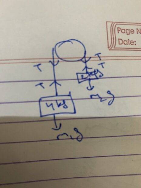

Two blocks of mass m1=4kg and m2=2kg are hanging in Atwood machine. The total downward trust on the pulley is—
##F=ma##
##(T-m1g)-(T-m2g)=(m1+m2)a##
But I think this is wrong eqn.
Rather than pull an equation from the air, analyze each block separately. Then you can combine the two equations to solve for the tension in the rope.

On taking g= 10 I got 2T= 53.34 N
On taking g= 9.8 I got 2T=52 N
Official answer is 54 N.
Always show your work. However, your results fit with what I get, while the official answer does not.
The approach I took was to note that all the masses share the same speed. We have a net unbalanced gravitational force of 2mg. We have a total inertia of 6mg. So it is immediately clear that the acceleration of the masses will be ##\frac{1}{3}g##.
If the left hand (heavy) mass is accelerating down at ##\frac{1}{3}g## then tension must be supporting ##\frac{2}{3}## of its weight. That's ##\frac{8}{3}g## Newtons
If the right hand (light) mass is accelerating upward at ##\frac{1}{3}g## then tension must be providing ##\frac{4}{3}## of its weight. That's ##\frac{8}{3}g## Newtons
Sanity check: The two tensions match, as they must.
Total of the two tensions is ##\frac{16}{3}g## Newtons
To a reasonably appropriate number of significant digits...
With ##g=9.80665## I get ##52.3021## Newtons
With ##g=9.8## I get ##52## Newtons
With ##g=10.## I get ##53## Newtons.
I see no way to justify rounding ##53.\overline{3}## up to ##54## unless one has a deathly fear of odd numbers or a monstrously huge slab of depleted Uranium under the lab.

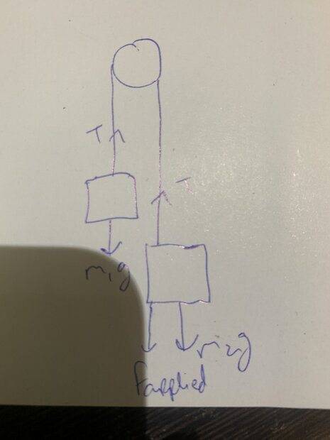

I want to ask does using one pulley minimises the effort needed to pull a mass up. I don’t think this is true. ##F=m_1g+m_1a## and if we use a pulley then ##F-T+T-m_1g=m_1a##
I want to ask why does we need more effort to pull a mass up directly as compared to using a pulley.
As I know Tension T required to pull up will be ##T=m_1g+m_1a##. But when we use a pulley the force will be ##(m_1+m_2)a+m_1g## to create the same acceleration a. So how is this force more than T?
Avoid introducing terms like ‘effort’ unless you define them. By ‘effort’, do you mean the net force on an object? Or the tension? Or something else?
Your first equation is OK: ##T=m_1g+m_1a##.
But the second equation isn't clear:
force = ##(m_1+m_2)a+m_1g##
You haven’t said which ‘force’ you mean.
And this equation ignores ##m_2##’s weight - there is no term ##m_2g##.
Maybe you can clarify the question.
I was wrong with second eqn. I edited it. The force F required to pull mass m1 will be same ##m_1g+m_1a## whether we use a pulley or not. To take the advantage of pulley we need to add an extra weight. I hope I am right!
The net force on ##m_1## is ##F_{net,1} = m_1a##. The tension in the rope is ##T =m_1g+m_1a##.
Take care to be absolutely clear to which of these you are referring, or it introduces confusion.
It depends what you mean by 'advantage'.
The main advantage of a single pulley in practical use is that it changes the direction of the required force. It is often easier to raise a weight by pulling downwards rather than by applying an upwards force.

Steve4Physics said:
The net force on m1 is Fnet,1=m1a. The tension in the rope is T=m1g+m1a.
I am referring to T which is created by weight and acceleration. This will be the force necessary to lift m1.
I meant to reduce the necessary force to lift we need pulley and counter weight.
