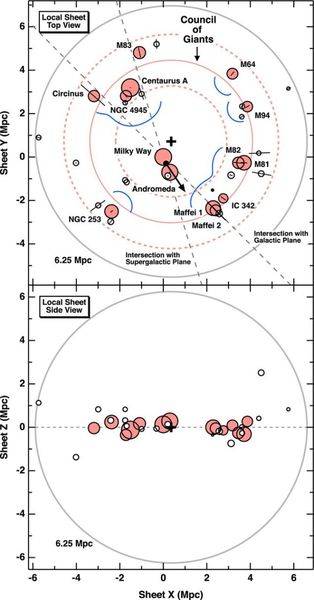

I've had a chance to do a bit more reading, and according to this article, if I read it right, the alien from the M81 galaxy should see us overtaking Andromeda, as shown in this image.

I'm afraid you're not reading it right.
The black arrow is the velocity of the Local Group(MW, Andromeda, and a bunch of nearby dwarf galaxies) with respect to the centre of the "Council", as the article dubs the galaxies surrounding and influenced by the LG.

The velocities of individual galaxies are not depicted. In that reference frame, both MW and Andromeda would be moving towards their mutual centre of mass.
