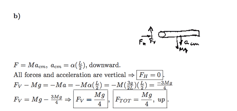

Please look at pictures.
What is it that Fv-Mg=-Ma? This does not make sense to me. Fv applies torque while Mg is a translational force. How can a force that is applied perpendicularly at a point of other than the center of mass cause translational motion?

A force is a force. Not translational. Not torque producing.
The bar's Center of Mass (C.M.) accelerates vertically with an acceleration of \displaystyle \ -\frac{3g}{4}\ .
The sum of the forces is equal to ##\ M_\text{cm}\,\vec{a}_\text{cm}\ ## .
The force exerted by the hinge is the only available force besides the weight of the bar.
But the Fv force is a torque producing force!
I mean "it is not a force because it is a 90° force acting on a rigid object (causes torque)"
Why say that ?
Torque is always torque about some point.
FV wasn't needed to find angular acceleration, α , was it ?

In part (a) I'm assuming (because its solution wasn't posted) that the torque about the hinge is what was used to find the angular acceleration of the bar. The reason to choose that point: Any force the hinge applies produces no torque about the hinge, So at that stage in solving the overall problem, FV is not needed. The only force producing a torque about the hinge is gravity, which in this case is treated as if it is applied to the center of mass.Once you have found FV, go back and find the torque that the two forces produce about the center of mass. From that determine the angular acceleration of the bar. (Be sure to use the relevant Moment of Inertia).

There's nothing special about a "torque-producing" force. All forces produce torque. How much torque a force produces depends on the reference point you use to measure it. If the force is F and the reference point is distance d from the line of action of F then the torque is F*d. Regardless of that, the force also features in the equation for linear motion.
If you apply a force at the middle of a rigid bar, perpendicularly to it, that produces no torque about the centre of the bar but does produce a torque about one end. The bar does not rotate about that end because the bending moment in the bar counters the torque. A springy bar would bend, giving you a (local) rotation about each end.
