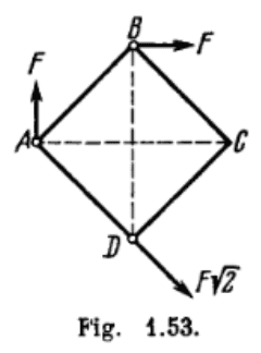

Three forces are applied to a square plate as shown in the figure below. Find the modulus, direction, and the point of application of the resultant force, if this point is taken on the side ##BC##.
##F=ma##
Free-body diagram of a square plate with corners A, B, C, D and dashed diagonals; forces F acting up at A and right at B, and F√2 acting down-right at D.

First, let's compute the resultant force.
$$F_{R,x}=F+F\sqrt{2}\cdot\frac{\sqrt{2}}{2}=2F$$
$$F_{R,y}=F-F\sqrt{2}\cdot\frac{\sqrt{2}}{2}=0$$
At this point we already have the magnitude and direction of the resultant force. We need the point of application.
My question is how to find this point. I don't actually know how to do this.

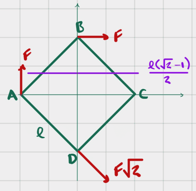

What I thought at first was that the resultant force would have to be applied at a point such that the torque produced by it would be the same as the net torque on the rigid body.
Let ##l## be the length of a side of the square plate.
Net torque about the center is
$$\vec{\tau}=-F\frac{l\sqrt{2}}{2}\cdot 2\hat{k}+F\sqrt{2}\frac{l\sqrt{2}}{2}\hat{k}$$
$$=Fl(1-\sqrt{2})\hat{k}$$
and if ##\vec{r}=x\hat{i}+y\hat{j}## is the position where the resultant force is applied we have
$$\vec{r}\times\vec{F}_R=(x\hat{i}+y\hat{j})\times 2F\hat{i}=-2Fy\hat{k}$$
If we equate this to net torque and solve for ##y## we get
$$y=\frac{l(\sqrt{2}-1)}{2}$$
which seems to be the purple line below
Square plate ABCD with vertices A, B, C, D and side l, forces F at A and B, F√2 at D, and a purple horizontal line labelled l(√2 − 1)/2 above the centre.
It seems not to matter what the ##x##-coordinate is.
The solution manual says the following:
##F_R=2F## This force is parallel to the diagonal AC and is applied at the midpoint of the side BC.
Which is not in accordance with my attempt at a solution. Which isn't surprising given that I am very unsure about how to find the point of application of a resultant force on a rigid body.
Quite so.
Check the last term.

You can make it a bit easier by choosing an axis that lies on the lines of two of the applied forces.
Note that the forces at B and D combined produce no torque about the centre. The total torque about the centre is due to the force at A only. The same torque would be provided by a horizontal force of ##2F## at half the diagonal distance above the centre. Hence through the midpoint of BC. No calculations needed!
