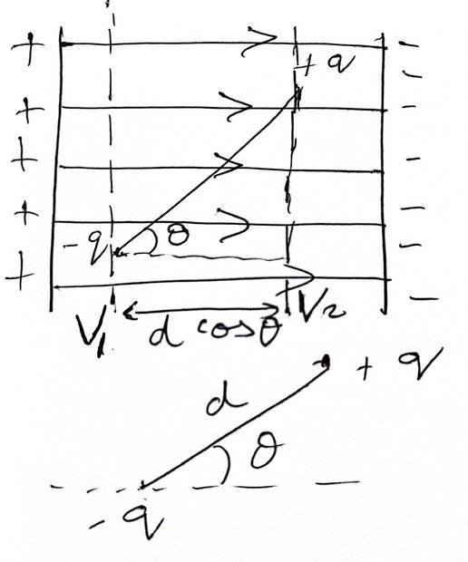

Is below the correct answer to your question?
I assume an electric field between a parallel plate capacitor as shown in diagram below. My goal is to find the work done by electrostatic forces on the dipole as it's moved from outside the field to into the field.
The dashed vertical lines through the electric field denote the equipotential lines that will be perpendicular to the horizontal electric field for potentials ##V_1## and ##V_2##. Now potential at a point is defined as the negative of the work done by the electrostatic force in moving a charge from infinity to that point.
So, ##W_1= - (-q)V_1## and ##W_2= - (+q)V_2##, where ##W_1## and ##W_2## are the work done by electrostatic force on charges ##q_1## and ##q_2## respectively as these charges are moved from infinity to their final positions.
So, ##W_{net} = W_1 + W_2 = qV_1- qV_2= q(V_1 - V_2)##.
Since ##E = - \dfrac {dV}{dx}## so ## E = \dfrac {- (V_2-V_1)}{d \times cos{\theta}}##.
Thus we get ##W_{net} = qEd cos {\theta} = \vec p . \vec E##
Hand-drawn diagram of a dipole in a uniform horizontal electric field between parallel plates, with field arrows pointing right, dashed equipotential lines V1 and V2, a dipole of charges -q and +q separated by d at angle theta, and a separate labelled sketch of the dipole with d and theta.
That works fine. A more elegant way to do this is to insert the dipole between the plates with its moment perpendicular to the electric field. Then the charges are moving along an equipotential and the work done by the electrical forces is zero. Once in, you rotate the dipole and calculate the work done by the net electric torque ##W=\int \tau~ d\theta.##

Yes, that is more easier than what I did.
In my derivation in post#13, each charge of +q and -q was moved separately from ##\infty## to their final positions, whereas in your approach the whole dipole is moved as one unit which seems a better approach.
