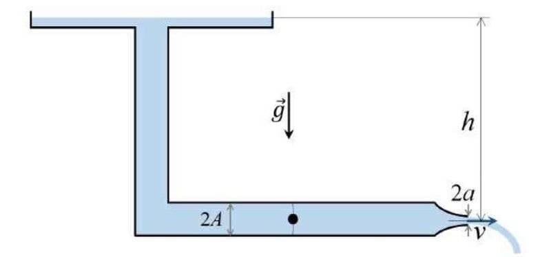

TL;DR Summary: Analyze, with the help of @Chestermiller, the importance of viscous interactions in a vertical geometry ("Falling ball viscometry") and in an horizontal viscous flow.
The following double experiment was conducted by me a few weeks ago. @Chestermiller and I discussed this experiment privately, and @Chestermiller advised me to open a thread on this Forum so that other users can also benefit from the discussion he and I will have on this topic.
Consider a fluid-dynamic resistance force of intensity ##F## (##\vec F = - \alpha \vec V##) opposing motion at velocity ##V## of a sphere (of radius ##R##, homogeneous, density ##\rho##) inside an incompressible fluid (water, with density ##\rho_W##, contained in a tube of radius ##A \gg R##).1) In the first experiment, the fluid is contained in a tube placed vertically and closed
below, and the sphere is placed inside the tube at various distances below the upper surface of the liquid and left free to move. The sphere left free in the liquid rises to the upper surface; at equilibrium it floats leaving a spherical cap outside the liquid.
I measured the ascent times with a precision of one hundredth of a second (times) as a function of the distance below the surface of the liquid at which the sphere is left (distances). The uncertainty on the distances traveled by the sphere can be considered to be 1 cm. I have reported these values in a table:

Values are: ##\rho_W = 1.000 \ \mathrm{g/cm^3}##; volume of the sphere ##V_R = 500 \pm 15 \ \mathrm{cm^3}##; volume of the sphere outside water ##V_C = 50 \pm 2 \ \mathrm{cm^3}##
My goal is to calculate (with some relative uncertainty) the viscosity coefficient ##\alpha##. @Chestermiller addressed me to the literature on "Falling ball viscometry".
So, I wrote the equation of motion given by the presence of the buoyancy force, the weight of the sphere, and the viscous resistance ##F = \alpha v##. Noting that the sphere reaches its terminal velocity after a few tenths of a second (the time it takes the sphere to accelerate), I assumed that the acceleration was zero and calculated the velocity as an approximation of the terminal velocity ##v \approx \frac{F_{\text{buoyancy}}-F_{\text{weight}}}{\alpha}##, or alternatively, ##v = \frac{2(\rho_{\text{sphere}}-\rho_{\text{liquid}})r^2 g}{9 \mu}##
But, as @Chestermiller noted, this works only assuming the pipe is horizontal, and that there is no buoyancy. Assuming the pipe is vertical only makes the problem harder. So, we would like to approach the problem from this point of view.
2) Subsequently, I varied the experiment by considering a reserve of the fluid to be contained in a container of cross-section
much greater than that of the tube considered above. The fluid discharges outwards through the tube (therefore, with an L shape) exiting from a circular opening of radius ##a < A## located at a distance ##h## below the level of the fluid in the container. (So, the total thickness of the tube is ##2A## and the total length of the opening is ##2a##).
I considered the two hypotheses in which there is or is not the sphere held stationary inside the tube (in the middle). Obviously, there is a difference in velocity in the two cases. In addition to describing the difference from a qualitative point of view, I would like an estimate of the two velocities.
At the very beginning, I calculated the efflux velocity with Bernoulli's law in the case where there is no sphere, and used the continuity equation in the case where there is a sphere, adopting the theorem of mechanical energy and work of non-conservative forces (work of viscous friction) to find the efflux velocity.
But, as @Chestermiller pointed out to me, Bernoulli's equation works only for steady-state inviscid fluids. Admitting the presence of viscous resistance makes the fluid viscous. So, Bernoulli's equation is no longer applicable. It needs to be approached in another way, and @Chestermiller suggested lubrication theory. Besides that, we would like to look at different cases: creeping flow with low Reynolds number, turbulent flow with high Reynolds number, treat Reynolds number as a parameter.

I never said any of this. You must have mis-interpreted me for selection 1.
The equation you wrote is correct if the sphere radius is much smaller than the pipe radius, and the Reynolds number for the flow is very low (so that you essentially nave creeping flow). The following oar gives correction factors if these two conditions are not satisfied: https://www.hindawi.com/journals/itees/2022/3897120/ That's all that needs to be said about situation 1 for now.

Situation 2 is very different from situation 1. Assuming that the final converging section and sphere are not present, let's see your analysis of situation 2 for a highly viscous fluid (negligible inertia).

I will try the following. Please take what I write with a grain of salt, as I have no expertise on the subject.
Consider the steady flow of fluid of constant density in fully developed flow through a horizontal pipe. Visualize a disk shaped element, concentric with the access of the tube, of radius ##r## and length ##\mathrm{d}L##.
The fluid pressure acting on upward stream is ##P_1 = P##, the fluid pressure acting on downward stream is ##P_2 = -(P + \mathrm{d}P)##. Since the fluid is possessing viscosity, we have to assume that shear stress will exist on the rim of element ##\sigma##. Since pipe is horizontal, ##x_1 = x_2##. Since flow is fully developed, we have ##V_1 \ \text{upstream} = V_2 \ \text{downstream}##
The resultant of all the forces acting on the fluid element would be zero, i.e. ##\sum F = 0##, from which: $$P_1 \ s_1 - P_2 \ s_2 + F_{\text{stress}} - F_{\text{weight}} = 0 \tag 1$$
where ##P_1 \ s_1 = P \pi r^2## is the force acting upward the stream, ##P_2 \ s_2 = (P + \mathrm{d}P) \pi r^2## is the force acting downward the stream, ##F_{\text{stress}}## is the force acting on the stream due to wall, i.e. shear stress on the rim of the element. I calculated it as $$F_{\text{stress}} = - (2 \pi r \mathrm{d}L)\sigma$$
Now substituting the values and dividing by ##\mathrm{dL}\pi r^2## eq. ##(1)## we get
$$\frac{\mathrm{d}P}{\mathrm{d}L} + \frac{2 \sigma}{r} = 0 \tag 2$$
Pressure drop will occur due to skin friction, therefore ##\mathrm{dp} = \Delta P## and ##\mathrm{dL} = L##. Eq. ##(2)## becomes: $$\Delta P = - \frac{2L \sigma}{r} \tag 3$$
Now to calculate friction we use Bernoulli's equation, combining it to the fact that the pipe is horizontal and the flow is fully developed, I get:
$$\frac{P_1}{\rho} = \frac{P_2}{\rho} + h \tag 4$$
Since ##\Delta P = P_1 - P_2##, we have ##P_2 = P_1 - \Delta P \qquad (5)##
Substituting ##(5)## in ##(4)##, I get: $$\frac{P_1}{\rho} = -\frac{\Delta P}{\rho} + \frac{P_1}{\rho} + h \tag 6$$ so, putting ##(3)##: $$\frac{\Delta P}{\rho} = h = - \frac{2L \sigma}{\rho r}$$ from which $$\sigma = - \frac{\Delta P r}{2L} \tag 7$$
The fluid will possess some velocity, hence considering a thin ring with radius ##R## and width ##\mathrm{d}R##, area is given by ##\mathrm{d}s = 2 \pi R \mathrm{d}R##
Using the definition of viscosity:
$$\frac{\mathrm{d}u}{\mathrm{d}R} = - \frac{\sigma}{\mu r}R \tag 8$$
Integrating from ##0## to ##u## and from ##r## to ##R##: $$u = \frac{\sigma (r^2-R^2)}{2 r \mu} \tag 9$$
The average velocity is given by: $$v = \frac{1}{s} \int u \mathrm{d}s \tag {10}$$
Substituting ##(8)## and ##(9)## in ##(10)##, I get: $$v = \frac{\sigma r}{4 \mu} \tag {11}$$
Substituting ##(7)## in ##(11)##: $$v = - \frac{\Delta P r^2}{8 L \mu}$$
Setting ##r = \frac{D}{2}##, we have: $$v = - \frac{\Delta P D^2}{32 L \mu}$$
This equation corresponds to the one you sent me privately, but the proof does not seem very precise to me. I would therefore ask you to rectify my incorrectness and propose your (certainly more accurate) solution. I would also like literature reference where this is shown in a more thorough manner.
If your request meant another solution or derivation, feel free to correct me and begin over.

This derivation looks pretty good. You can find the detailed derivation in Transport phenomena based on an annular shell balance. Your final answer is correct. The other relation for your diagram is ##-\Delta P=mgh##

First let me correct myself. I meant that $$\Delta P=-\rho g h $$where ##\rho## is the density of the fluid. D is the diameter of the tube.
The equation I wrote with $$\frac{v^2}{2}$$ includes the inertial contribution to accelerate the fluid down the tube. The equation I wrote without the term is for negligible inertia.
The point is that, even for a constant diameter tube without an end contraction, the pressure drop is not zero (as predicted by Bernoulli.)
You say, "how to continue?" What would you want to include next?

I would like to continue with the selections we talked about: turbulent flow with high Reynolds number and treat Reynolds number as a parameter.
Of course, we should also examine the case where there is the sphere. Situation which, as you said, is more difficult than the one we solved.

For selection 2, without the sphere present, the analysis for turbulent flow can be derived from the development in Transport Phenomena, Chapter 7. Let's see what you come up with.

I went through Chapter 7 of 'Transport Phenomena', not before reading parts of Chapter 5. This book is so detailed and full of information that I really struggled. I could not digest all the information that is written in the whole chapter. I am not very satisfied with what I have been able to produce, but I will try.
The mechanical energy balance is
$$\frac{v^2}{2}+ \frac{\Delta P}{\rho} + h_f = 0 \tag 1$$
where ##h_f## is the term contributing to the head loss due to friction from the pipe wall and ##\Delta P = - \rho g h \qquad (1.1)##
The Darcy equation gives the friction head loss for flow in a straight pipe: $$h_f = 2 \frac{fL}{D} v^2 \tag 2$$ where ##f## is a dimensionless friction factor and ##D## is the diameter of the pipe.
Substituting ##(1.1)## and ##(2)## into equation ##(1)##: $$-gh + \dfrac{v^2}{2} + 2 \dfrac{fL}{D} v^2 = 0 \tag 3$$
We can obtain an estimate of the friction factor ##f## using the empirical relation known as Blasius equation, applicable to smooth pipe and turbulent flow with Reynolds numbers in the range of ##4,000 < Re < 100,000##
$$f = \dfrac{791}{100 \ Re^{\frac{1}{4}}} \tag 4$$
where ##Re = \frac{\rho v D}{\mu} \qquad (4.1)##
So, substituting ##(4.1)## in ##(4)##, and ##(4)## in ##(3)##, we have:
$$-gh + \dfrac{v^2}{2} + \dfrac{791 \ L \mu^{\frac{1}{4}}}{50 \ D^{\frac{5}{4}} \rho^{\frac{1}{4}}} v^{\frac{7}{2}} = 0$$
I do not believe that this derivation and the final result are correct. I therefore explicitly request your assistance.
In Eqn. 4, the 791/100 should be 791/1000. Otherwise, if you did the rest of the algebra correctly, the remainder of the development is correct. Very nicely done. Congrats. Cudos on mastering the information in Chapters 6 and 7. You seem to have a knack for fluid dynamics.
You can now see how, under many circumstances (particularly turbulent flow), the inviscid Bernoulli equation can give highly incorrect results.
You are making me blush. I didn't think I would do this selection correctly as well.
You are absolutely right about the numerical correction. Good catch. I am going to correct my mistake.
I think now the good stuff will come. Still missing to analyze the selection in a way that treats the Reynolds number based on the average velocity of the fluid relative to the sphere and based on the sphere diameter as a parameter (as you said).
More importantly, the case in the presence of the sphere, for which you promised to show lubrication theory. I foresee something quite difficult.
$$f = \dfrac{791}{1000 \ Re^{\frac{1}{4}}} \tag 4$$
$$-gh + \dfrac{v^2}{2} + \dfrac{791 \ L \mu^{\frac{1}{4}}}{500 \ D^{\frac{5}{4}} \rho^{\frac{1}{4}}} v^{\frac{7}{2}} = 0$$
This is the correct result.
