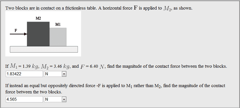

My teacher said there isn't a special kind of formula, you just derive it from f=ma.
This is the diagram:
I assume you want the contact force between those two masses. Your teacher is right. Just apply Newton's 2nd law.
Hint: First find the acceleration of the system.

Yes. I found the acceleration.
Good. Now apply Newton's 2nd law to M1 alone.
To find the the answer in N ?
So-> F= m1 * acceleration that I found for the whole system ?
Ok, I found the answer. But scientifically, I don't understand how.
My teacher said that the contact force for both blocks is the same. How is that possible ? So if a bee flying at 10 km/h hits a car moving at 30 km/h the forces between both bodies is the same. How is that possible ?
That's Newton's 3rd law. Whenever two objects interact, they exert equal and opposite forces on each other.

Here's the problem to make it clearer:
My acceleration is: 1.32 m/s^2
And then I just multiplied 1.32 m/s^2 by 1.39 m/s^2.
If I do 1.32 m/s^2 *3.46 m/s^2 I don't get the same answer...
Right.
That's correct.
The contact force is not the only force acting on m2. To apply Newton's 2nd law to m2, you must use the net force: ƩF = m2*a.
I get it. Thanks.

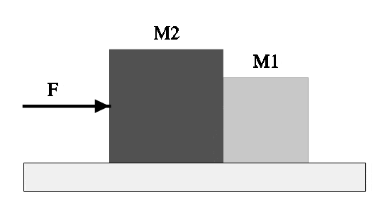

Can you help me to draw a FBD for this problem ?
Sure. First identify the forces acting on each block. What forces act on m2? On m1?

Not sure but
m1-> force coming from m2 and force going forward.
m2->force from F (6.40N) and force of contact.
What do you mean by 'force going forward'? The only thing in contact with m1 is m2.
Right. They act in different directions, of course.

Only one force acts on m1. In what direction does it act?
Well there is the force of contact... Does this count ?
I GOT IT !

I don't quite understand what you are doing here. You want:
ƩF = m2*a
The two forces are the applied force "F" which acts to the right and the contact force "Fc" which acts to the left. If you choose a sign convention so that the right is positive, then you have:
+F -Fc = m2*a
6.2 - Fc = 3.46*1.32
And so on.

The applied force F acting to the right; the contact force from m1 acting to the left.

That doesn't specify which arrow goes with which force. I'd draw it like this:
Code:
<---(Fc)---[m2]---(F)--->
