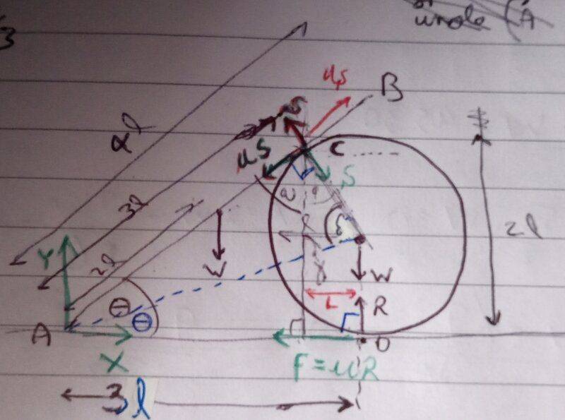

Could I please ask for help with the following:
Printed textbook problem 2: a uniform plank AB of length 4l and weight W rests on level ground and leans against a cylinder of radius l, with contact point 3l from A; asks for frictional forces and to show mu is at least 8/21.
Here's a diagram:
Handwritten free-body diagram of a cylinder resting on a slope from point A, with forces W, R, S, F = uR and uS labelled, lengths 3l, 2l, 4l and angle theta marked.
(in what follows, for clarity, I write L to represent the lower case L of the diagram).
My diagram wrongly shows u (the coefficient of friction) to be the same at both points of contact. Since this image was taken I have realized that, it does not affect the following where I refer the coefficient of fruition at C as v.
For the first part of the question the answer in the book is "8W/45 at all points of contact".
I have done that part and agree with the book answer. I obtain F = uR = vS = 8W/45
Intermediate results which I derived and used on the way are that: S = 8w/15 and that R = 23w/15. Also cos(2ɵ)=4/5 and sin(2ɵ)=3/5
For the last part (in this part the coefficient of friction at both points of contact are the same = u) I reasoned that I would balance the horizontal forces acting on the cylinder, like so:
uR + uS*cos(2ɵ) - S*sin(2ɵ)=0
substituting in for S, R, cos(2ɵ) and sin(2ɵ) from above formulae leads to u = 8/49
not 8/21.
Have I made an arithmetic error or have I erroneously applied the wrong physics?
Thanks for any help,
Mitch.
Your diagram is a little hard to read. It would be clearer if you drew separate free-body diagrams for the plank and the sphere. I agree with your answers for the normal forces S and R.
You should not assume that a static friction force ##f_s## is always related to the normal force ##N## as ##f_s = \mu N##. The correct relation is ##f_s \leq \mu N##.

Well, I'm a little closer to the answer:
Firstly, yes, as Steve4Physics says, A is also a point of contact. And by resolving horizontally on the system as a whole I also get that X = 8w/45. So that completes the first part of the question.
I still believe that my analysis of the cylinder alone, balancing the horizontal forces, which leads to u = 8/49 seems correct. So this would say that, for no slipping at point of contact between cylinder and ground we require u >= 8/49 = 0.163 (to 3 decimal places).
But, taking Steve4Physics' advice made me realize that the rod may slip before the cylinder does. So I balanced the horizontal forces on the rod as follows:
X - S * sin(2ɵ) + u*S * cos(2ɵ) = 0, this leads to u = 1/3. which is greater than 8/49 and so slipping would occur here first, i.e. to not-slip here would require u >= 1/3 = 0.333 (to 3 decimal places) , but this is slightly different to books answer of u >= 8/21 = 0.381 (to 3 decimal places).
I tried balancing vertically for rod only, get same result of u = 1/3.
Would anybody be able to show me where I am reasoning wrongly?
If you know the static friction force f and the normal force N at a point of contact, what can you say about the possible values of u at that point of contact?
As a numerical example, suppose f = 2.0 Newtons and N = 8.0 Newtons. What is the range of possible values for u?
Since you know the friction force and the normal force at each of the three contact points in this problem, you can do this type of analysis at each of the points and compare results.
Big thanks to both of you for your help. I needed each piece of advice. I get it and agree with the book's answer. Thanks again.
