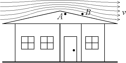

A house has a roof with an area of 220 m2. Wind blows over the top with a speed of 10 m/s. The density of air is 1.29 kg/m2. The air inside the house is stagnant. Point A is just inside the roof, and point B is outside the roof at the same height.
(a) What is the difference in pressure (PA - PB) between points A and B?
(b) What force is applied to the roof by the inside air?
This is where I'm stuck at
I don't know what equations to apply here, they all involve mass, but that's not a given.

Have you studied the Venturi effect? Look it up.
Yes, I've studied it, but how does that apply here?
Um, air flowing faster over roof than under roof... air pressure difference... area of roof...
Oh yes, I realized that, but I don't know where to go from there, what equations should I use.
What equation pertains to the venturi effect? Look up venturi effect.
