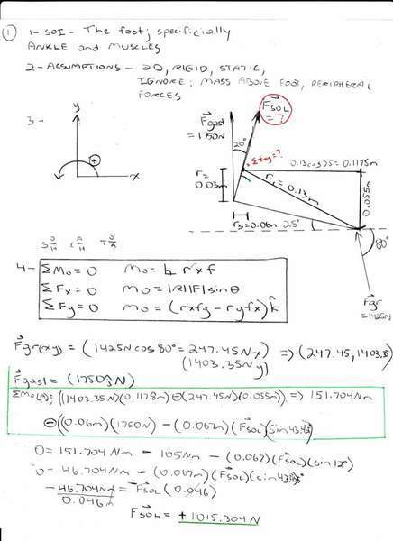

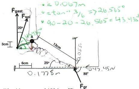

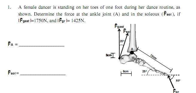

QUESTION 1
Diagram of a foot standing on its toes with the ankle joint labelled A, showing the forces Fgast, Fsol and Fgr, with angles 20°, 25° and 80° and lengths 3 cm, 6 cm and 13 cm, plus blanks for FA and Fsol.
WORK TO SOLVE QUESTION 1/SECTION1 - CONFIDENCE 80%
Handwritten free-body diagram of a foot with labelled forces F_gast, F_sol and F_gr, distances 3cm, 6cm and 13cm, angles 20°, 25° and 80°, and a force of 247.45N.
Handwritten biomechanics worksheet: a free-body diagram of the foot with an ankle pivot, force vectors labelled F_gastr and F_SOL, distances and angles, a moment equation block, and a final result F_SOL = +1015.304 N.
  • Diagram of a foot standing on its toes with the ankle joint labelled A and the heel labelled H, showing forces Fgast, Fsol and Fgr, with angles 20°, 25° and 80°, and distances 3cm, 6cm and 13cm.
  • Hand-annotated free-body diagram of a foot with forces labelled Fgast, Fsol and Fgr, distances of 3cm, 6cm and 13cm, angles of 20 and 25 degrees, and a 247.45N force at 80 degrees.
  • Handwritten biomechanics solution showing a free-body diagram of the foot with applied forces, lever arms labelled 0.13 m, 0.055 m and 0.06 m, angles of 25 and 80 degrees, and moment equations summing to F_SOL = 1015.304 N.

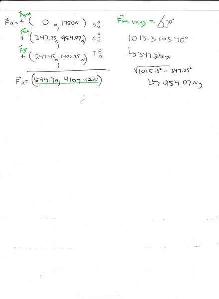

SECTION1 FINAL
Handwritten vector addition of forces: F_a equals (0, 1750 N) plus (347.25 N, 954.07 N) plus (247.45 N, -1103.35 N), giving F_a = (544.7 N, 4107.42 N); on the right, a 1015.3 N force at 70 degrees gives components 347.25 and 954.07 N.
  • Handwritten vector sum of forces: F_a equals (0, 1750 N) plus (347.25 N, 954.07 N) plus (247.45 N, 1103.35 N), giving F_a = (544.7 N, 4107.42 N); a second column shows 1015.3 cos 70 degrees and sqrt(1015.3^2 - 347.25^2) = 954.07 N.

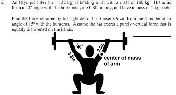

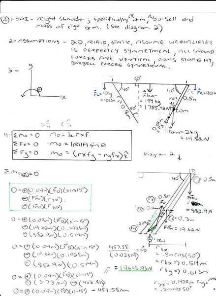

QUESTION 2
Diagram of an Olympic lifter holding a barbell overhead with arms at 40 degrees, showing 0.8 m bar length, 0.5 m arm center of mass, and the printed problem text.
WORK TO SOLVE QUESTION 2 - CONFIDENCE 60% - 20000N? I think I did something wrong...
Handwritten physics working on lined paper: a free-body diagram of an arm with forces and angles labelled, the moment equation Mo = r x F, and a series of torque sum equations with numerical values.
  • Diagram of an Olympic lifter squatting with a barbell overhead, arms raised at 40 degrees from horizontal, labelled 0.8 m forearm-to-bar length, 0.5 m to the center of mass of the arm, and 40 degrees at the elbow.
  • Handwritten physics work on lined paper: assumptions list, a labelled sketch of a bent arm with a dumbbell, a second diagram of the arm with forces, and torque sum equations with numerical values.

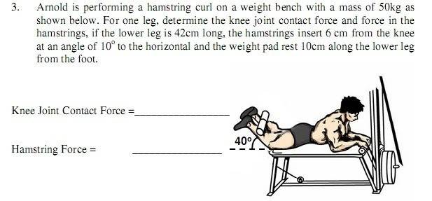

QUESTION 3
Diagram of a man lying prone on a leg curl weight bench, one leg raised with a weight pad on the lower leg, a 40° angle marked at the bench, and blank lines labelled Knee Joint Contact Force and Hamstring Force.
WORK TO SOLVE QUESTION 3 - CONFIDENCE 75%
Handwritten solution to a lower-leg biomechanics problem: a free-body diagram of the leg with a knee joint, muscle force, 490.5 N weight, 0.06 m and 0.32 m distances, a 30 degree angle, and the moment equation sum of moments equals zero leading to F_ham = 5232 N.
  • Line drawing of a man lying prone on a weight bench performing a hamstring curl, with a weight pad on his lower leg, a 40 degree angle marked at the bench, and blank answer lines for knee joint contact force and hamstring force.
  • Handwritten biomechanics solution: leg free-body diagram with x-y axes, leg held 30 degrees from horizontal, force vectors labeled F_ham and F_r1 = 490.5 N, moment equations and a computed hamstring force of 5232 N.

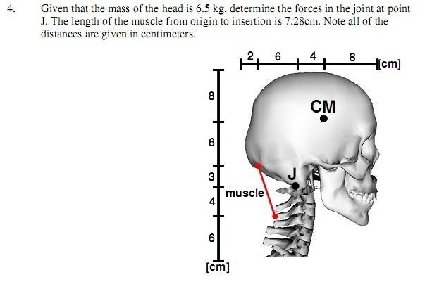

QUESTION 4
Side-view diagram of a human skull and upper cervical spine with a red arrow labelled muscle running from the back of the skull to the neck, point J at the joint, centre of mass marked CM, and horizontal and vertical centimetre scales.
-CONFIDENCE 0%
--I wish I knew how to start this problem.
  • Diagram of a human skull in side view with a red arrow labelled muscle running from the back of the skull down to the neck vertebrae, point J at the joint, CM marked on the skull, and centimetre scales with marks 2, 6, 4, 8 along the top and 8, 6, 3, 4, 6 down the left side.
