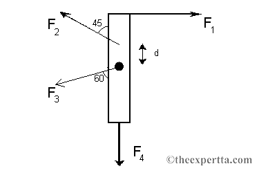

A uniform beam of mass m = 0.6 kg and length L = 0.3 m can rotate about an axle through its center. Four forces are acting on it as shown in the figure. Their magnitudes are F1 = 1.5 N, F2 = 1.5 N, F3 = 1.5 N and F4 = 1.5 N. F2 acts a distance d = 0.12 m from the center of mass.
Diagram of a uniform vertical beam pivoted at its centre, with four forces: F1 horizontal to the right at the top, F2 at 45 degrees up-left at the top, F3 at 60 degrees down-left, and F4 straight down at the bottom; d marks a distance from the centre to F2's line of action.
What is the angular acceleration?
I = Ʃmr^2
I = ∫(r^2)dm
α = Ʃτ/I
I = (0.6 kg)(0.15 m)^2 +(0.6 kg)(0.12 m)^2 + (.6 kg)(0.15)^2 = 0.03564 kgm^2
Ʃτ = 0.225 + 0.127 = 0.352 Nm
α = 0.352/0.03564 = 9.88 rad/s^2
This is apparently the wrong answer and I don't know where I messed up. [STRIKE][/STRIKE]
Bishop556 said:
I = Ʃmr^2
That formula is for an aggregate of point masses. For a continuous distribution of mass through a body, such as a solid bar, you need the integral formula below (or off-the-shelf solutions to it).
I = ∫(r^2)dm
The moment of inertia is a property of the body only …
it is completely independent of the forces acting on it, or of their positions. :wink:​
