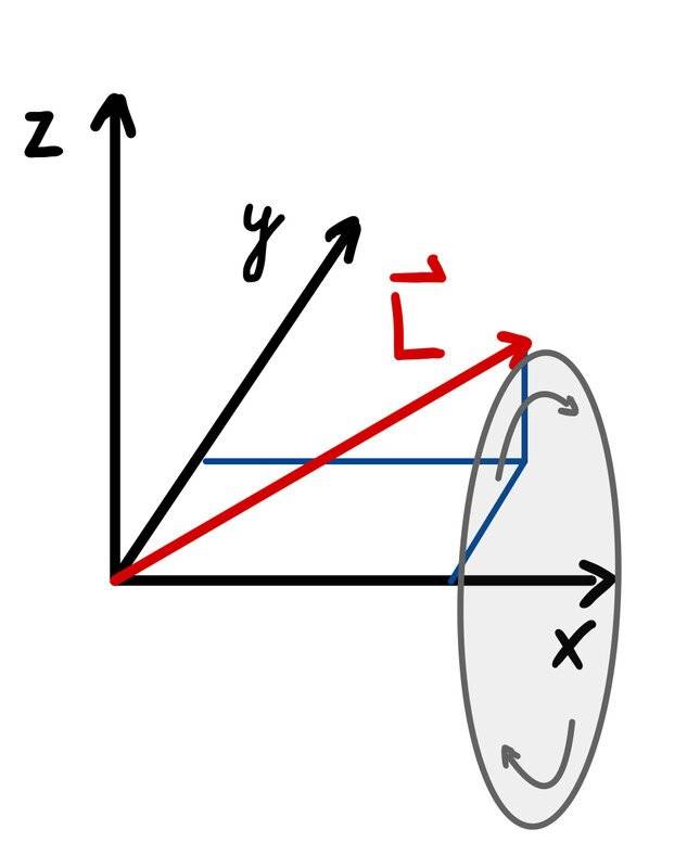

Diagram of x, y and z axes from the origin with a red arrow labelled L from the origin to a point, a blue right-angle projection onto the axes, and a grey ellipse in the x-z plane with curved arrows showing circulation about the x-axis.
From the geometry and because the bar tip aligns with angular momentum*, we conclude that:
##(\sqrt{L_y^2+L_z^2})/L_x = r/2d\implies r = 2*15cm*\sqrt{0.13^2*0.0454^2}/20 \approx 0.885\times10^{-2}cm##
##\biggl(\sqrt{L_y^2+L_z^2})=\sqrt{I_y^2\omega_y^2+I_z^2\omega_z^2}=\sqrt{I_y^2(\omega_y^2+\omega_z^2)}\biggr)##​
Angular velocity of this motion is ##\Omega_n = B = 846[_{rad}/_{s}]##
which clearly disagrees with the answer given.
* I assume the rod tip aligns with angular momentum (i.e. is parallel to it), yet I am unable to prove it beyond reasonable doubt (inertia tensor is diagonal, so angular velocity components are parallel to angular momentum components?)
Your results so far look good. Note that ##\Omega_n## is the angular velocity that the vectors ##\vec L## and ##\vec \omega## precess about the x-axis of the body frame as measured in the body frame. So, we don't expect this to equal the angular velocity of point ##A## in the lab frame. You can see from your results that the angle between ##\vec L## and the rod remains constant. So, the rod will not try to align with the angular momentum. Also, you can easily show that ##\vec L##, ##\vec \omega##, and the rod always lie in the same plane.
The tricky part is going from these results in the body frame to visualizing what's happening in the lab frame. In the lab frame ##\vec L## is a fixed vector (conservation of angular momentum). In the lab frame, the x-axis of the body (i.e, the rod) and the instantaneous angular velocity vector ##\vec \omega## precess about the fixed vector ##\vec L## such that ##\vec L##, ##\vec \omega##, and the rod always lie in the same plane. One way to visualize it is to use the concepts of the "body cone" and the "space cone" and to imagine the body cone as rolling without slipping on the space cone. But I don't know if you have studied this. Doing a quick web search I found https://www.researchgate.net/publication/231043528_Inertial_rotation_of_a_rigid_body which you can download. I have not read it, but glancing at it, it looks pretty good. Section 5 of this paper states the results that are relevant to your problem.

$$Notice that ##\vec L' = I_x\omega_x'\hat {i'} + I_y\omega_y'\hat {j'} + I_z\omega_z'\hat {k'} = I_x\omega_x'\hat {i'} + I_y(\omega_y'\hat {j'} + \omega_z'\hat {k'}) = (I_x - I_y)\omega_x'\hat {i'} + I_y\vec \omega'##
I.e. the angular momentum vector lies in the plane spanned by the x'-axis and angular velocity vector, so the vector must rotate as does the angular velocity vector
Moreover, the tip of the rod ##A## lies along ##\hat{i'}## at all times. Since ##\hat{i'}\cdot \vec L' = const.## and ##\hat{i'}\cdot \vec \omega' = const.##, the angle between these vectors and the rod's end does not change.
Summarizing, in the body frame the x'-axis is fixed in space, while the angular velocity ##\vec\omega'## and angular momentum ##\vec L'## are rotating about that axis with the same angular frequency ##B## with the constant angle between them. At any time, all three (the x'-axis and vectors) lie on the same plane.
Also at ##t=0##, i.e. shortly after the impulse, it must be that all primed quantities are equal to the unprimed ones, because the axis in both frames coincides at that time. (so ##\vec L = \vec L', \vec\omega= \vec\omega'##, etc. for ##t=0##)
We would like now to see, what happens in an inertial frame of reference.
Knowing that angular momentum ##\vec L## is fixed in space in that frame, we conclude that x'-axis and ##\vec\omega## must rotate around it.
Note that ##\vec\omega' = \vec L'/I_y + B\hat{i'}##
or for ##t=0,\space \vec\omega = \vec L/I_y + B\hat{i'}##
We know that relation between inertial frame and rotational frame is:
##\biggl(\frac{d}{dt}\biggr)_{lab} = \biggl(\biggl(\frac{d}{dt}\biggr)_{rot.} + \vec\omega \times\biggr)##​
Therefore (for t = 0):
$$\biggl(\frac{d\hat{i'}}{dt}\biggr)_{lab} = \biggl(\biggl(\frac{d\hat{i'}}{dt}\biggr)_{rot.} + \vec\omega \times \hat {i'}\biggr)=\biggl(\vec L/I_y + B\hat{i'}\biggr)\times \hat{i'}$$
And
$$\frac{d\hat{i'}}{dt} = (L/I_y) \hat L \times \hat {i'} $$
which is the same form as
##\vec v = \vec\Omega \times \vec r##
and tells us that the rods end ##A## rotates around ##\vec L## with the angular frequency ##\Omega_n = L/I_y \approx 153.85 s^{-1}##
At the same time (t=0), the rod coincides with the x-axis and rotates around ##\vec L##. So for small angles:
##L_y/L_x \approx r/2d \implies r \approx 0.885\times10^{-2}cm##
That all looks good to me. :oldsmile:
Thank you for checking this! I appreciate your help.
