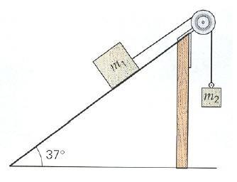

mass 1 is 2.0 kg, the static and kinetic coefficients of friction are .30 and .20 respectively.
a) What is mass 2 if it travels uniformly upward?
b) Downward?
c) mass 1 and 2 are at rest?
Part c is the easiest. Friction and Tension are going to be the same so [tex]m_{2} = \mu_{s}m_{1}[/tex].
Part a, I did the same thing about except I used [tex]\mu_{k}m_{1}[/tex].
Part b, [tex]m_{1}g = \mu_{k}m_{1}g[/tex]
[tex]m_{2} = m_{1}/\mu_{k}[/tex]
Is this right?

I'm guessing its a triangular slope of some sort with one mass on either side.
Hi inutard! :smile:
ah, but then we'd have heard about a θ :wink:
Good point. Maybe its in the diagram that he is neglecting to show us (As he also mentions tension but he neglected to talk about a rope or string in his question).
Damn, I forgot to attach the picture! I'm a she BTW... lol

mmm … inutard :smile: guessed right! :biggrin:
ok then, there's a θ = 37º, which isn't in your equations …
put it in now …
what do you get? :smile:
Pardon me about the gender mixup! Remember that there's not only frictional force opposing direction of motion but also a force to the bottom-left (depending on the angle) that is caused by the normal force on block m1
