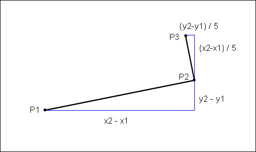

See the attached image first. Given that I know points P1 and P2, what would the equation be to get point P3, given that the angle is 90 degrees and the distance from P2 to P3 is 1/5 the distance from P1 to P2?

I haven't a clue where to begin. It's been 8 years since the last time I had to think about calculus. I found some equations on how to rotate a point by 90 degrees but the only examples are to rotate around (0,0).
This calculation has to be performed hundreds of times in a short amount of time so if the equation is too complex i may just fudge it by increasing point P2's y by L/5. It simplifies the problem but doesn't provide desirable results in all situations.

I've had some more time to think about this. We won't even need trig!
In the figure, note that we form two similar right triangles, with a scale factor of 1:5.
To get the x-coordinate of P3, subtract (y2-y1)/5 from x2.
To get the y-coordinate of P3, add (x2-x1)/5 to y2.
