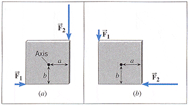

A rotational axis is directed perpendicular to the plane of a square and is located as shown in the drawing. Two forces, 1 and 2, are applied to diagonally opposite corners, and act along the sides of the square, first as shown in part a and then as shown in part b of the drawing. In each case the net torque produced by the forces is zero. The square is one meter on a side, and the magnitude of 2 is 6 times that of 1. Find the distances a and b that locate the axis. Note that a and b are not drawn to scale.
a = ? m
b = ? m
THE PICTURE :
Two diagrams of a gray square with a dot marked Axis inside, distances a and b measured from the dot to the edges, and forces F1 and F2 applied at opposite corners along the sides; in (a) F1 points right on the bottom-left and F2 points down on the top-right, in (b) F1 points down on the top-left and F2 points left on the bottom-right.
sum of net torque=Fl
Ok, so I got this help, but i don't think it's right...anyone else able to check this to see where it's wrong?

  • Two diagrams of a grey square with a dot marked as the axis, distances a and b measured from it to the edges, and force arrows F1 and F2 on opposite corners: (a) F1 pushes right at the bottom-left corner and F2 pushes down at the top-right; (b) F1 pushes down at the top-left corner and F2 pushes left at the bottom-right.
You are right and the solution is wrong. The theta's in the problem are the angles between the force vector and the vector connecting the axis to the point where the force is applied. It's going to be tough to make them all 90 degrees. On the other hand the question is pretty nasty. There is not a unique solution for a or b! I don't know quite what the person who framed this question was thinking of. I would suggest you just try and find one point by confining your search to the diagonal of the square connecting the two forces. That makes the problem at least manageble and the angles are easy.

I agree, I'm finding it impossible to find a and b! I wanted to use the diagonal also, but I only know the large diagonal is the sq.root of 2 and it has a correlation to the sq.root of a squared + b squared...there arent any numbers to use though!
If you are along the diagonal then a=b (at least in the second picture). Compute the distance to the points where the force is applied. sin(theta) for both forces will be the same - just opposite in sign, right?

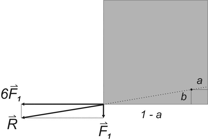

From the first setup one gets that
[tex]b = 6a[/tex]
From the second setup one gets that
[tex]\frac{6}{1} = \frac{1 - a}{b}[/tex]
since the action line of the resultant needs to go through the pivot point in order to produce a zero torque.
  • Free-body diagram of a grey square with force vectors at its lower-left corner: 6F1 pointing left, F1 pointing down, and their resultant R pointing down-left. A dotted line runs from the corner to a point on the right edge, labelled a horizontally and b vertically, with the bottom edge labelled 1 - a.
