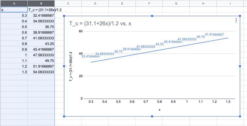

  • #41
kuruman said:
Correct. Now for the plot. Use a spreadsheet if you know how.
  • #42
I think you're done. Congratulations! I hope you learned something from this experience.

  • #43
paulimerci said:
Looks like I plotted for ##T_c## vs ##x##. S
Definitely! It was a humongous problem and I didn't believe I can do it and I thank you so much for guiding me throughout! Thanks to @haruspex for his guidance too!
