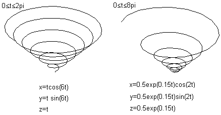

A spiral (elic) drawn on a cone with fixed pitch L in cylindrical coordinates is
[tex]z= L\ cos \alpha\ \frac{t'}{2\pi}[/tex]
[tex]r= L\ sen \alpha\ \frac{t'}{2\pi}[/tex]
[tex]\theta= \ t'[/tex]
After each turn of [tex]\theta[/tex] which takes a time [tex]2\pi[/tex], the distance between the 2 points will be [tex]\sqrt((L\ cos \alpha)^2+(L\ sen \alpha)^2) = L[/tex]
They told you [tex]\omega = kt[/tex] so since [tex]\omega =\frac{d\theta}{dt}[/tex], we integrate [tex]\omega[/tex] to find [tex]\theta= \frac{kt^2}{2}[/tex]
So we need to replace [tex]t' = \frac{kt^2}{2}[/tex] in the expressions above.
Now we got the parametric expessions of [tex]\theta, z, r[/tex], we can find the speed and acceleration.

Don't call me sir, please. :)
Just to be sure, we are talking about this object (the left one).
Basically it's a radious moving at a constant speed, so e.g.
[tex]\theta =kt, \ \ \ \omega = k[/tex]
while the radious sweeps, (thinks of a radar on the screen of a boat control room), the length of the radious increases linearly, so [tex]r = k_1 t[/tex].
While it sweeps and increase its lenght, it rises linearly over the xy plane, so [tex]z = k_2 t[/tex].
If you're convinced of this, then you can try to find the pitch between two near arcs of the spiral. You can take all the point which are on the same angle [tex]\theta[/tex] then find their distance or pitch.

Ok, so susbstitute [tex]t[/tex] with an appropriate expression.
If you look in my first message there is already an answer to this, if not the complete solution.
