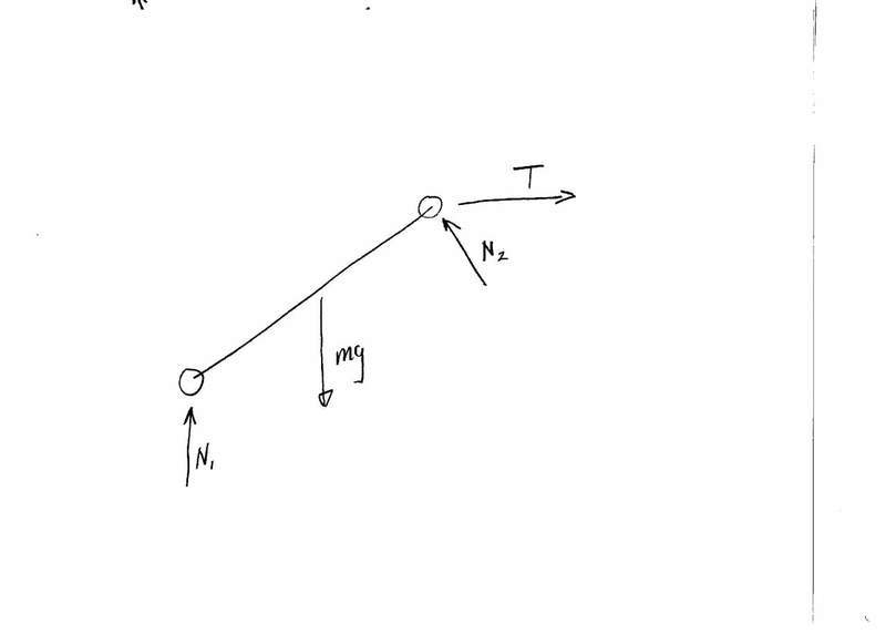

I used sum of forces in x y direction and sum of moments
So my problem here is that I solved for Ay (1275.3N) and now I have to solve for T
The obvious approach would be to use sum of forces in x direction after doing sum of forces in y to find B. Well I did that and found that B = 2550.6 which is double Ay and equal to mg. B is also perpendicular to the bridge thing. Now when I do sum of forces in x direction i do T = Bcos30 but that's wrong apparently.
Which part am I doing wrong? Is my B wrong?
I calculated B like so:
Fy:0 = Ay - mg + Bsin30
Please help :)
Does this help? %^)
  • Hand-drawn free-body diagram of a rod leaning from lower left to upper right, with a weight mg acting downward at its middle, normal forces N1 and N2 pointing up and up-left at its ends, and a horizontal tension T pulling right at the upper end.
unfortunately it does not. I figured that much. When i break down the N2 into it's components I still get a wrong answer for T
i think that it is important to know whether there is friction with the rollers at A and B.
There is not, so you would think that the x component of the normal force at B would be equal to T, but it's not!
If you explain more explicitly how you got B then I can try to give some help.
Direct copy from my first post... i don't think i can be more explicit than this..
It has to be. What other forces in the x direction are there?
From what I understand there are 2 forces. B and T both pointing in the opposite direction. Is that correct?
I think that sin must be replaced by cos.
One must be careful here. The SIN30 component of B is in the opposite direction of T.
