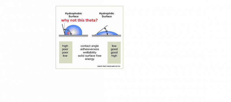

I have to draw a contact angle.
Actually I've to detect the edge of the droplet first. It looks like a semicircle. Then I've to draw a tangent which gives me the contact angle.But I am not getting how to draw a tangent.I know a tangent is a line or plane which touches a given curve or solid at a single point.I want to know what will be that single point in my case(i.e in drawing contact angle)?The image below will depict my problem more clearly
Why not theta in red contact angle rather than black one?
It looks to me like the droplet curves inward just before hitting the surface, so the angle wouldn't be 90 degrees.

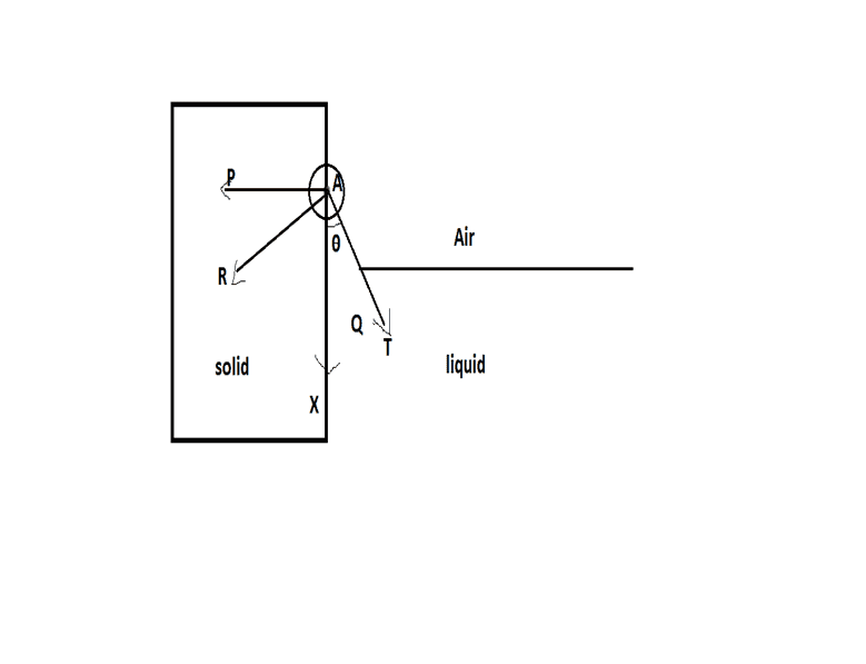

I have got some questions on this picture .
Vector AP is resultant adhesive force,why?Why it is in this direction?
This can be very ambiguous, to do manually. A more robust method is to fit some analytic function to the entire shape of the drop:
http://www.kruss.de/services/education-theory/glossary/drop-shape-analysis/
http://www.researchgate.net/profile/Sjoerd_Rienstra/publication/226994659_The_shape_of_a_sessile_drop_for_small_and_large_surface_tension/links/0c960524954aa24f2f000000.pdf
"To a first approximation" (translation: we know it isn't quite this because gravitational forces distort droplet shapes, but the distortion is so small it isn't worth messing with for surface tension measurements) droplet shapes are spherical. The droplet given in the schematic is at "just the limit" of sphericity, that is, it has been formed by adding liquid slowly and has not formed a "flat top" which is taken as the "first approximation" indication of a departure from spherical shape. The horizontal diameter of the drop is the diameter of the "first approximation" sphere. The tangent angle then becomes the angle of a line perpendicular to a radius drawn from the center of the sphere (or its circular cross-section) to the intersection of the surface with the drop.
Can you Please answer post 3 also.
It was extremely helpful.
The contact angle then becomes the angle between line perpendicular to a radius drawn from the center of the sphere (or its circular cross-section) and the intersection of the surface with the drop.
Did you mean the same?
What does it mean "Solid surface free energy"?
gracy said:
post 3 also.
Is there any sort of discussion, legend, labelling, explanation at all with the picture? As it is, it makes absolutely NO sense.
:(Sorry.I thought it is enough,I have drawn this with really hardwork.I will try to give more information.

It denotes a case of liquid(eg.kerosene)partially wets the solid,resultant adhesive force(vector AP)between liquid and solid acting on a molecule A is stronger than resultant cohesive force (Vector AQ)between liquid molecules.Therefore resultant force of vector APand vector AQ is vector AR which lies inside the solid.
In equilibrium state,the tangent AT to the liquid surface,must be perpendicular to resultant force.Therefore liquid molecules like molecule A creep upwards on the solid surface.

Bystander said:
If the surface tension is less than that of the solid substrate, it wets the solid; if greater than that of the solid substrate, it does not. Think water in glass, and compare it to mercury in glass.
I understand. I confused terms "solid surface" and "solid substrate"...
That's beautiful.
Now can you please answer post 3?
You mean at an angle that intersects the glass-kerosene interface rather than parallel to it? That is a phenomenon characteristic of "partial wetting." I wouldn't expect to see that for glass-kerosene, but depending on the surface treatment of the glass (it may have an adsorbed film of water on it), it's possible.
I wanted to ask how resultant adhesive and resultant cohesive forces have been given directions?
You get the direction of the cohesive force from the contact angle; it also lies in the plane of the liquid surface. The adhesive force appears to be normal (perpendicular) to the solid surface. It's a measure of how much the two materials want to stick to each other, and since the solid surface has the only permanent "shape," we have to look at forces normal to that surface as far as its attraction to/by liquids.

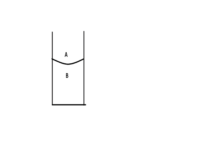

ok can you please explain me what it it means'the pressure n concave side is greater than the pressure on the convex side.
Why pressure at point A is greater than at point B?

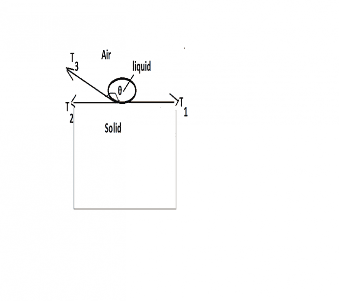

Here T1=Force due to surface tension at the liquid-solid interface
T2=Force due to surface tension at the air-solid interface
T=Force due to surface tension at the air-liquid interface
How direction of T1,T2 and T3 is obtained?

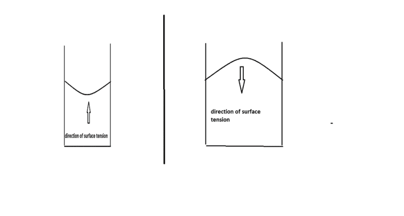

Sir,what is the direction of surface tension?Is it same as direction of contact angle?
Pressure inside a balloon is greater than that outside, and the same case holds for distortion of an interfacial surface. The concave side of the surface is always at higher pressure.
T1, and T2 are interfacial (surface) tensions between the solid and liquid (which is not wetting in the illustrated case), and the solid and air, and both are parallel to the solid surface (if the liquid were to wet the surface, direction of T1 would be different). T3 is the surface tension between the air and the liquid, and the direction is determined by any of several relationships that are not obvious from the drawing.
Yes.
surface tension induces reduction in surface area.
Here in these pictures,direction of surface tension shows that it wants a flat surface.Does flat surface have smaller surface area than curved one?
T1, and T2 are interfacial (surface) tensions between the solid and liquid (which is not wetting in the illustrated case), and the solid and air Respectively?

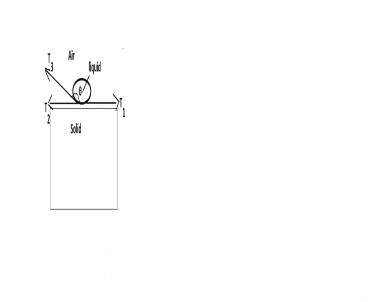

It is (the picture in 25th post)actually like this
After this correction of my picture will your answer be still same?
