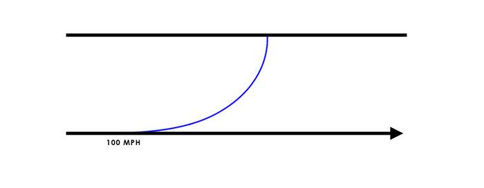

Thanks for your help. I"m actually not sure what you are asking, but let me try posing the question a different way with illustrations to see if that helps.
Let's say the astronaut is traveling along a line at 100 mph. They need to reach a parallel line as quickly as possible, but they need to have stopped all their velocity along the initial axis by the point they hit the second line. We can say the lines are 100 feet apart if that helps. We can also say their combined mass and thrust capabilities allowed 1 g of acceleration. One way of doing this would be to slow down to whatever speed was needed and then take a circular path with constant radius and velocity by pointing their thruster in the opposite direction to the center point of a circle they traveled on.
Diagram of a path from one horizontal line to a parallel line: a red curve starts on the lower line, bends upward, and meets the upper line. A red dot on the upper line is labelled CENTER OF FORCE. The lower black arrow is labelled 100 MPH.

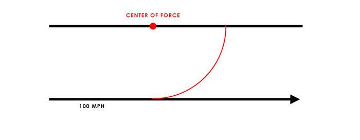

Alternatively I would think it would be faster if they used their thruster to slow down and turn at the same time. I would think that would give them a Euler spiral shaped path, but please let me know if I am wrong. I'm primarily wondering where the center of force they aim their thruster opposite of would be for this path. Would it move?
Diagram of a curved path from a horizontal line to a parallel line above, with an arrow along the bottom line and the label 100 MPH at its start.
If the thrusters deliver a fixed thrust, the best direction to fire them must (surely?) be towards the centre of a circular path with a radius, set by the equation
F = mv2/r
I can't think of a path that would achieve a 90° change of direction, any quicker, with the same final speed.
There are variations around this; for instance, when she/he doesn't insist on the speed being maintained. The quickest way to just get a 90° course change would be to fire them backwards and leave just enough 'squirt' to give a finite velocity at right angles to the original.

The circular path will only be the quickest if the thruster's maximum thrust is exactly what would be needed to make a turn with a radius equal to the distance between the lines. If the thrust is less then that, then the astronaut will still have forward velocity when they reach the 2'nd line. If the thruster is capable of higher thrust then a quarter circle turn would have to be followed by a straight path to reach the second line.
This is actually a very interesting problem. I'm not sure what the solution is yet, but its only a quarter circle in 1 very special case.
Thanks, yeah I was not thinking the circular path would be the ideal solution, I just put it there as an example of a possible solution to explain the problem better. I put the 100 mph, 100 feet, 1 g constraints because I would think that would require deceleration prior to the circular path. Or I was thinking ideally combining the deceleration with the turning in the Euler spiral example. Not sure if you can tell by the illustrations, but the blue line in the 2nd illustration is the 1st 90 degrees of a Euler spiral.

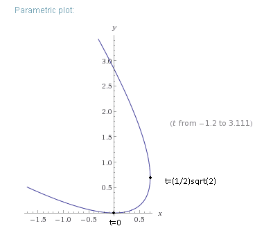

Firing the thruster at 45° to the original direction is faster.

Each method discussed takes a time which is some factor c multiplied by mv/F. If the final speed doesn't matter then we just have to come to a halt: c=1. For the 45 degree solution, c=√2. For the circular quadrant, ##c=\frac{\pi}2##.
To see that the 45 degree must be the fastest way of finishing with the same speed, consider that the net change in momentum required is in that direction. With a thrust limited to F in magnitude, it must be quickest to keep that F in the desired direction throughout. If we direct the thrust in any other direction for a time, it reduces the momentum change in the desired direction.
Those time factors also apply if the final speed equals initial speed. The 45 degree solution also requires less space, with only 1/√2 of the circular arc radius.
The graph you get with 45 degree thrust is a rotated parabola
with an initial speed of v in the x direction and a desired speed of v in the y direction.
x = vt - (1/2sqrt(2))at^2, y = (1/2sqrt(2))at^2 with t from 0 to vsqrt(2)/a
if v = 1, and a =1 you get the following graph
Parametric plot of a curve starting at the origin (t=0), bending upward to the right to a point labelled t=(1/2)sqrt(2), with the curve continuing up and to the left toward y about 3.3; t ranges from -1.2 to 3.111.
we start at t=0 going to the right, and end up at x=y=t=(1/2)sqrt(2) going up.
thanks to http://www.wolframalpha.com/input/?i=x=t-(1/4)sqrt(2)t^2,y=(1/4)sqrt(2)t^2
