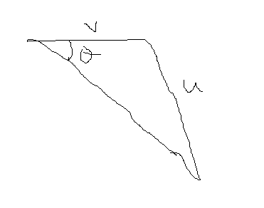

The original question is from AP French's Classical Mechanics. It's about a boat trying to catch up with a ship. I've interpreted the question as follows: which is to express tan θ as a function of u and v.
I tried working with vectors, where v is actually -v in vector notation.
where tan θ = (-v . (u-v))/(-v x (u-v)
but that only complicates things as we don't know much about the angles.
So in this question, θ is fixed, u is fixed and v is fixed.
Tried using the cosine rule, but that only gives the unknown length...

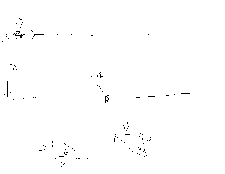

Okay, here's the original question:
A ship is streaming parallel to a straight coastline, distance D offshore, at speed V. A coastguard cutter, whose speed is u (u<V) sets out from a port to intercept the sip.
(A) Show that the cutter must start out before the ship passes a point a distance
D√(V2 - u2)/u back along the coast.
(B) If the cutter starts out at the latest possible moment, where and when does it reach the ship?
My idea is: The fastest way for the cutter to approach the ship is to (in frame of the ship) move directly at a straight line to it.
Then letting the distance be x, we have a right angled triangle with tan θ = D/x.
The relative velocity diagram is drawn too, with the cutter moving at an angle θ.

A couple of things I notice:
Your θ is in a different place this time, in the relative velocity diagram.
While that may represent the fastest way for the cutter to reach the ship, the question was about the position of the ship at the latest time the cutter could leave port and still intercept. Perhaps I am misunderstanding your thinking.

Let's try a different approach:
1) Shortest time is achieved when the relative velocity (in the frame of the boat) is when the cutter moves directly towards the boat.Writing an expression for time:
t = x/(u cosθ + v)
t = D/(u sin θ)To find the shortest time with respect to x, we have to find dt/dx = 0...I tried to substitute sin θ = √ 1 - cos2θ but that made the expression very complicated..

I'm heading out, but some very quick observations:
I assume the port is located a horizontal distance x from the D vector.
The cutter ship must travel the perpendicular distance D from shore at minimum to have any chance to catch the boat. Any direction at an angle to the shore will cover more distance and take longer. You should be able to draw a conclusion from that.
The second thing that crossed my mind is at time t, the cutter can be on any point of a circle centred at the port with radius Ut. The streaming ship will be located at (Vt,D). The intersection of the line and circle (that changes with time) will show the course the cutter should take.
I don't know if the latter is a dead end but a little more thought may lead to an analytical solution.
